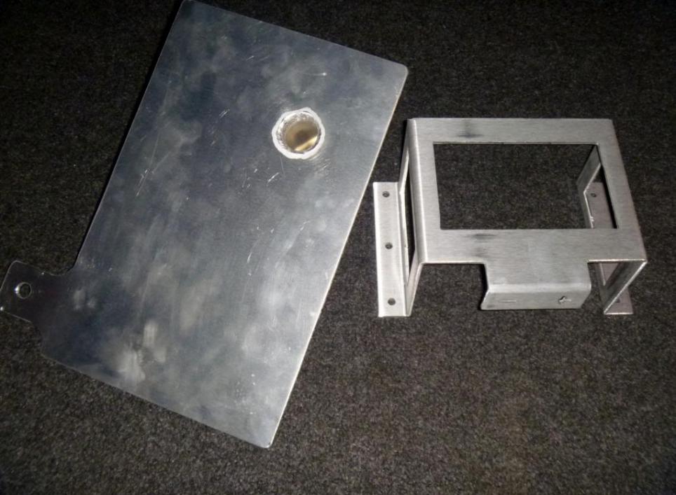

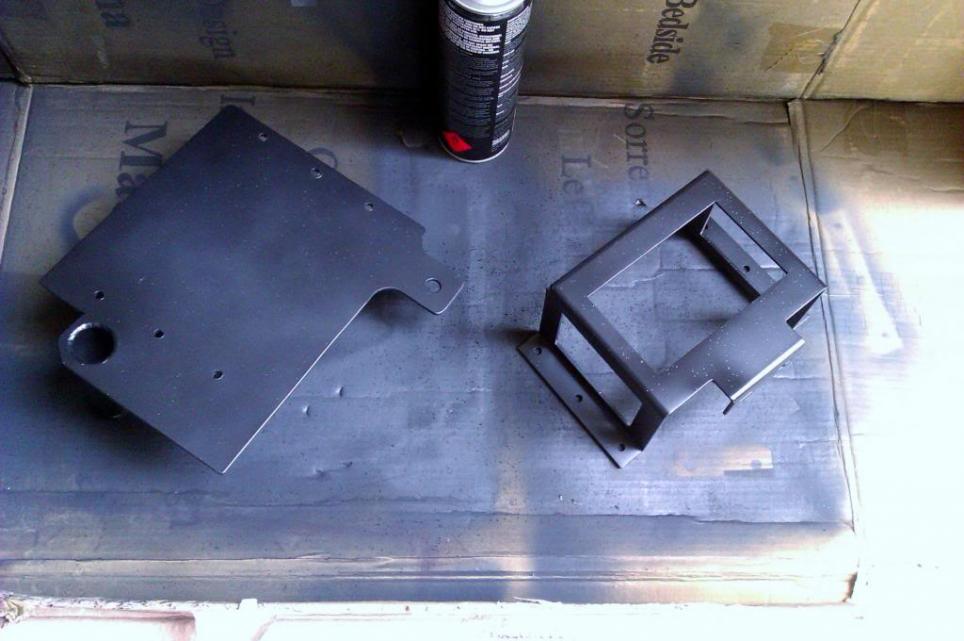

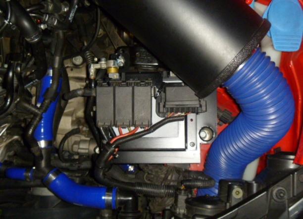

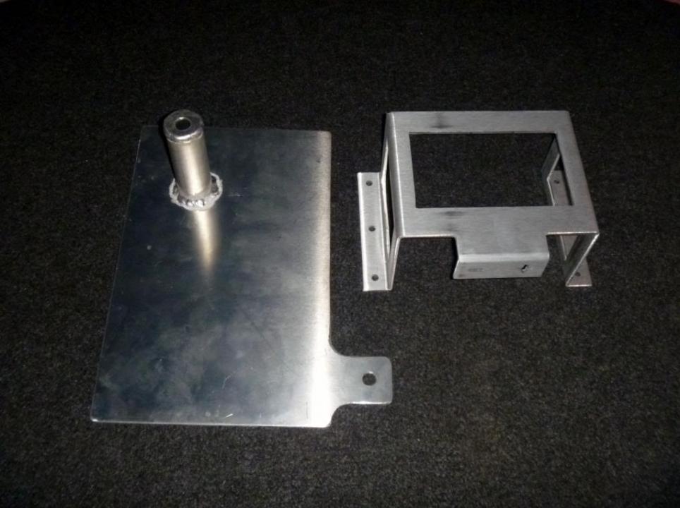

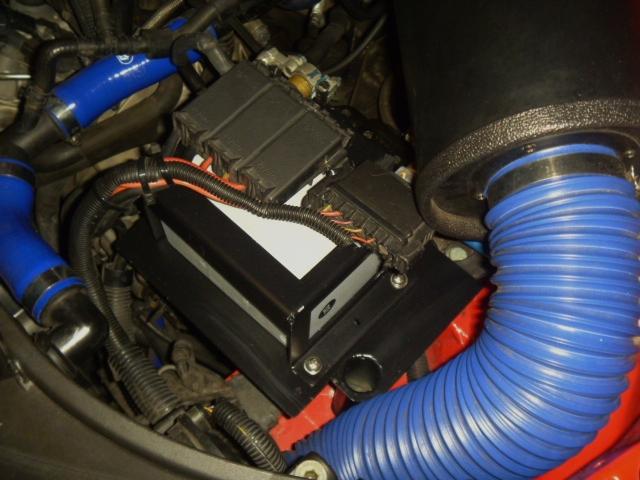

              • Update time! But first sorry Jase, didn't phone you back last night. And Sam I'll drop that battery tray to you this week
                Ok for ages I've been wanting to sort out a different battery tray/box solution. Thought about relocating to the boot but thought it was too much work in the end and adding all the extra weight from the cabling sort of defeats the purpose of the lightweight battery also. And I'm putting the Devil on even more of a diet very soon.
                So big thanks to Greg from Carformance for putting together an aluminum tray with oem mounting points for me. Seen on the left
                On the right is a bracket made for a Braille battery which happens to be the same size as the DEKA I have. The custom tray needed some trimming with a hacksaw to make room for my cold air intake and gave them both a quick spray (might get them powder coated later as I did a ****ty job it)
                And the final product
                Only problem now is finding a place for the massive 42DD ultimate catch can. I'm thinking of swapping it for a stealth version they have and mounting it under the CAI barrel somewhere.
