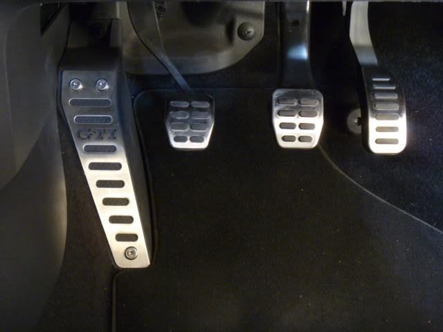

                    Aluminum dead pedal cover from ebay. Looks even better in person too.

                    • I picked up that dead pedal cover about a year ago .... finishes it off nicely, could never get a good photo of it though, looks heaps better in person.
                      • Totally right, that's the best of 6 shots

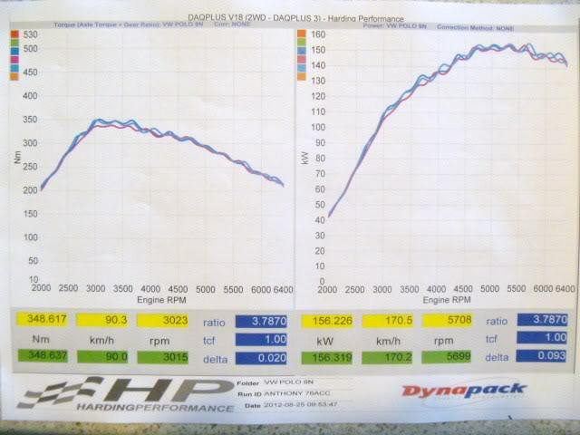

                            • Howdy, well it was a excellent day out at Harding Performance on Saturday. I'm sure all the data will be very well analysed and posted soon. But here are my individual efforts
                              Very happy to see the upgraded fuel pump has done the job as you can see the peak of the torque curve has no retardation now! All in all the peak figures won't mean much until Sharkie posts the analysis of all the Polo's from the day. But I'm very happy with the consistency of all the runs which is largely due to SEAT intercooler which experienced no heatsoak what so ever!
