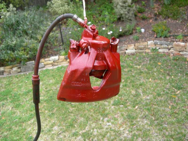

    Hey all finaly spent some time this arvo cleaning the Audi S3 brakes i have. Spent about 2 hours with a wire brush and sand paper trying to get rid of all the dust that has been weathered into the calipers. Think i am almost there.
    The Rotors are 312mm i think the standered ones are 288mm.
    The next step is to rub down with a solvent to remove any left over grease and oil.
    Ill try to paint them as soon as i get a good day.
    I am told that they should fit under the 16" wheels.
    Standered Brakes.
    TT Brakes(Thanks to Guy Harding pics are from his project polo.)
    Same size as S3 i balive.
    Will be taking the calpiers after painting to a Brake place to have them all checked out seals ect.
    The plan then is to go for EBC green stuff pads, good fluid, Braided lines and then maybe ATE Power Rotors should have the pogo stopping in no time at all.
    Will post agin as soon as they are painted and agian once they are on the car.

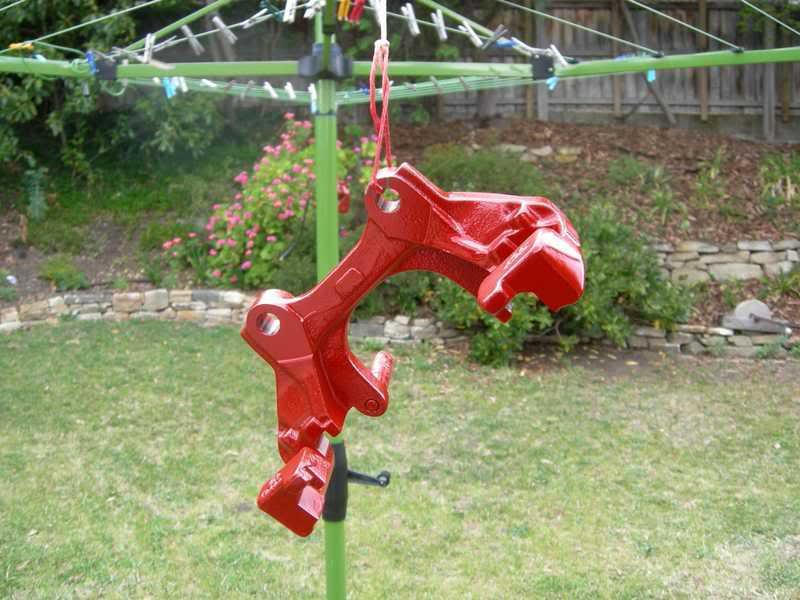

                            Just put a few coats on the carriers and one on the calipers starting to look better.
                              hey u missed a spot Rob
