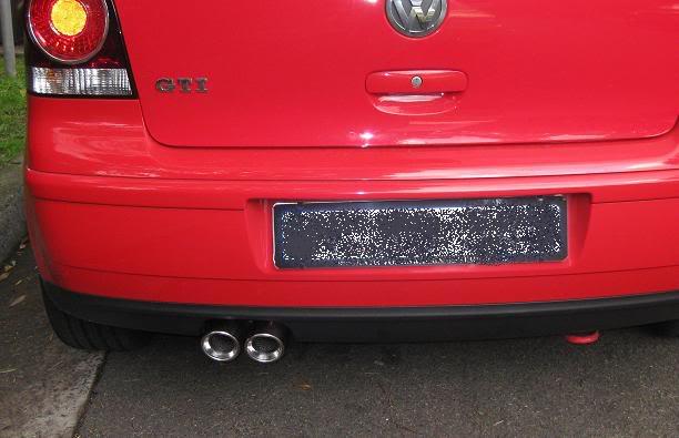

      I have a pretty big single 4 inch tip. Lets people know theres something going on with my Gti, a little more aggresive than stock. But i also have a full stainless system.
      If I didnt change my system i would be content with the stock twin tips..

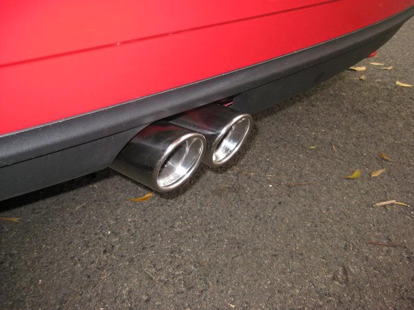

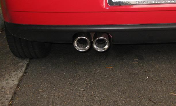

        Took the guy over an hour, the stock pipes were too close together.
        Happy with the look, seems to fit a little better without looking modded.
          Fair enough you are happy with the look - they look AWESOME!!!
          Just the tips yeah? You didn't change the entire muffler?
            No change to muffler, I didn't want to make it louder - just thought the stock tips looked a little small for the cutout in the rear lip.
            These tips (off the shelf at Midas) have a muffling mechanism (you can just see the small perforations in the inner barrel) similar to a straight through muffler. If anything probably make the car quieter. Didn't notice any change to the power (not that i expected to).
            These are 3" stainless tips, stock was about 2.5" chrome

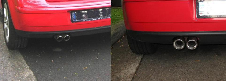

              Looks nice. Thats probably the ideal tip for these cars. Like stock but better.
                Not a great before and after, but you get the idea.
                I didn't notice how undersized they were until I saw a post recently by someone else who had done this.
