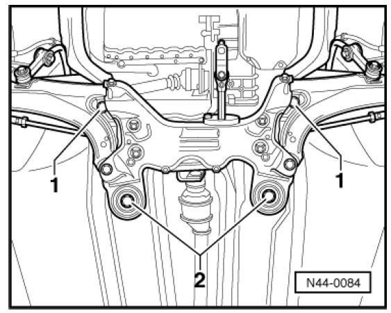

          Me would like to know more on how this is done, Jimmy.

            It all gets done by a special tool, and moves the subframe left to right, doenst alter heaps but does adjust, Rick at Ricks Wheel align knows exactly the procedure. Give me your email addy and i can send you some piccies

                Whilst not the same car on my R the procedure is as follows:
                If values exceed the tolerances, the vehicle's transverse inclination
                must be checked and corrected if necessary.
                Only by moving the subframe is it possible to alter the camber to a
                minimum degree.
                – Loosen bolts -1- and -2-.
                – Move subframe until camber on both sides is
                even.
                - Tighten bolts to 100 Nm +90 degrees.
                Moving the subframe can change the caster!
                After moving subframe, check caster.

                    Yeah, but it doesn't change the overall camber... Just the difference between left and right.
