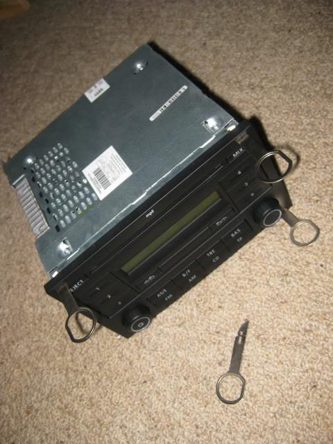

      You need 4 of these type of tools; you can get them off other eBay sites.
      Here's one I prepared earlier!
        ^so that's all u need! wow so much easier than a Toyota (my old Echo was a bitch, had to pull out the side panels)!

          Unluckily for some reason i only have 2 of the key things and now they're stuck in my head deck. woo! lol
          I guess i'll have get to get a couple more
            p.s. when i get the extra key things do i just pull it out? or is there more technique? and what do i search on ebay? lol
              When I did it, the bottom right key locked in and enabled me to pull the headunit out. I had troubles with the keys too, hence why they are still in the headunit lol!

                    Disposable? They can be used over and over again 'til the cows come home but yes you could dispose of them after one use if your heart desires I s'pose. But considering they cost money+shipping to get I wouldn't recommend it.
                    The ones you could buy off eBay tend to be a bit flimsy but shouldn't give any problem - for a real quality item look to these if you could spare a few extra bucks. You'll need four of the ones that are shaped like steak knives.
                      I removed and replaced my original deck 2 months ago. Used 2 very flimsy keys not 4 and had no problems. Did the right side first and then the left. Takes patience and time however eventually got it out with no markings on the original stereo or surrounds.

                          Thanks for the help guys, it seems like i'll have to get another 2 keys cos they're stuck in the top slots and it feels like something is gonna break if i pull too hard
                            I have some removal keys I can loan you.
                              I did the cheap way and just used two screw drivers to wedge the plastic fce off the unit then undo the clips holding the rest of the unit in place. Once out the plastic face just clips back on. Just needed to be careful not to scratch surrounding plastic.
