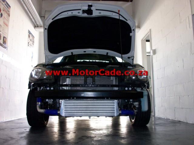

          ive got an interesting link id like to share. this engine probably has more mods then you can poke a stick at including, battery and washer bottle relocation.they seem to be using the same space i queried before.(behind the lefthand fog lights)

            Originally posted by mikepologti View Post
            ive got an interesting link id like to share. this engine probbaly has more mods then you can poke a stick at including, battery and washer bottle relocation.they seem to be using the same space i queried before.(behind the lefthand fog lights)
            http://motorcade.co.za/index.php?mai...roducts_id=562
            Wow! Some beast. It looks as though they have put extra holes through the lower grills (inside the foggies) to get the cold air they need - neat idea.
            Dave

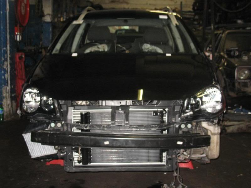

                  After a year of owning a BMC CDA Intake which I never got around to installing (like most things I buy- ha!), I think I may be bothered this weekend.
                  Q: Has anyone removed the windscreen washer bottle?
                  -If so, where did you end up putting it?
                  -If so, how easy was it to remove? I know from the top its just connected to the negative terminal on the battery which is bolted to the chassis, but what about underneath?
                  I think if I have any chance of doing an air duct to the front bar, I would go 2.5" or 2.75" silicone hose to go down the right side of the engine bay bypassing the stock battery .. as in
                  I was thinking a silicone flexi hose that way I can squeeze it through as I think it'll be more durable. But if you say otherwise, let me know.
                  Would anyone say this is too small of a hose to ram air into? I'm thinking not, but would love to hear your thoughts.
                  Thanks guys.

                  • #24
                    The water bottle is bolted down behind the left fog light, not much working space there
                    Hoping these pics will help
                    ---------- Post added at 09:25 PM ---------- Previous post was at 09:12 PM ----------
                    • #25
                      Thanks for that.
                      Maybe I can remove the water bottle all together and reroute a smaller one somewhere else in the engine bay.
