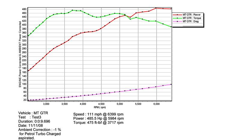

          Drivetrain losses are not as simple as 20-30%.
          Dyno of GTR (AWD remember) with driveline loss shown. It never ever gets to 30%.
          At moderate RPM driveline losses are < 10%!
          Driveline losses increase (absolute and %) as RPM/speed increased.
              Thats a VERY big call. Trent had a dyno run with us in Brisane in his MKIV R32. On that day I managed 122.2kW atw (APR quoted 152kW at the fly) and he managed 122.1kW atw (VW quoted 177kW at the fly). Is that not a 31% loss for Trent. And hey, mine works out spot on 20%.
