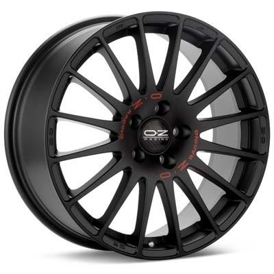

          Just ordered and it will arrive at the end of Jan!!
          and will be running on 215 40 R17!

            Dam they are pretty slick looking rims ey. They'll look hot against the white duco. Where's the best place to get Oz rims? Easily the best finished rims I've seen. I bet they don't come cheap.

              Very nice choice mate! Love those Oz racing rims!

                    What did you pick? the OZ?
                    I'm planning to run hankook VENTUS V8RS H424
                    Pic from Google:

                        Double checked with the OZ website for Polo 9N
                        Superturismo GT - RACE SILVER + BLACK LETTERING
                        SIZES ET PCD x HOLES AT CODE
                        7x17 38 5x100 1 W0167220082
                        8x17 35 5x100 1 W0167320082
                        and check with polo9N.info
                        if it is 8x17 ET35 I need to use 205/40 R17 or 225/35 R17
                        If it is 7x17 ET38 I need to use 205/40 R17 or 225/35 R17
                        215/40 R17 is only for Cross and Fun polo.
