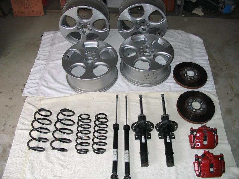

    Well I bought a bunch of stock Polo GTI stuff from Timbo today so I can get to work on my Polo TDI which is a new addition to the family ...
    This is my first go at modding a car, and I'm playing it safe by sticking with factory VW gear.
    Does anybody have the springs colour coding figured out? My Polo came with a tow pack, so it probably already has stiffer springs in the back ... I'm guessing. I just noticed the colour dots today and I'm guessing they mean something.
    I just checked the stock Polo TDI with tow pack - Rear: Yellow,Yellow,White,Orange Front: Red, Blue, Blue, Blue (and small white dot).
    The stock GTI gear is - Front: Red, Red, Red, Green,Green and Rear: Orange, White, White, Orange

              With the diesel engine up front, your springs & dampers may need to be "heavier" than those on a GTI. But then, the GTI ones may be heavier than the diesel ones already.

                Yeah - Timbo had a look at the spec sheets, and the TDI is only 30kg heavier than the GTI (but I'm sure it's distributed differently), so hopefully it won't be a problem.

                      A friend up here has fitted GTI suspension to a 1.6l Match, and with the new suspension it sits a little higher at the front than a GTI does. Still, with the rear swaybar fitted, it's a very capable handler.
                        Well I spoke to the learned folk at the local dealership (like we have a big choice in Canberra) and with his official VW hat on he had to advise me that any changes to the stock configuration may void my warranty...
                        But he was able to advise me *not* as a VW mechanic, that there should be no problem at all with swapping out the shocks/coils, provided that the mounts were the same. He also said the tow pack doesn't provide different springs, so all's good on that front.
                        He did warn against changing the calipers/rotors because the master cylinder on the TDI is not as big as the GTI's one he thinks, and could cause all sorts of nasty problems (can anyone confirm this?).
                        Interestingly, VW doesn't provide the information to decode the colour dots on the coils to find out the spring rating. The service department just matches the colours to what the VW manual says.
