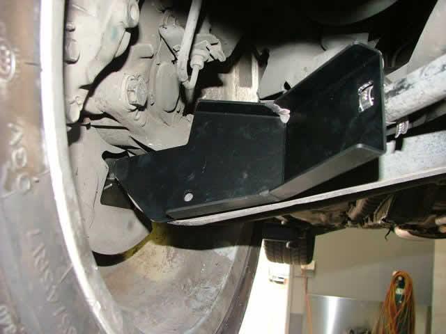

          • Winton is tough on brakes, right angle turn, short straight, right angle turn, short straight etc. Boiling brake fluid produces gasses which (just like air in the system) causes the brake pedal to go spongy as it compresses the gas. After a day so so the gas rises/works its way up to the master cylinder and the pedal isn't so spongy any more. But once it's been boiled it has lost whatever it gave off in the gasses, a byproduct of which is often a colour change to a dirty brown. Plus it often smells "burnt". New fluid required.
            I assume you have removed the backing plates, if not do it, it's well worth it. One of the side effects of wider wheels is less airflow gets to the brakes. Before the full on brake ducting on the Skyline and EVO I used to run these;
            Easy to bend up out of alloy sheet and a couple of hose clamps as retainers.
            Cheers
            Gary
            Golf Mk7.5 R, Volvo S60 Polestar, Skyline R32GTST
                  Cheers
                  Gary
                  check - backing plates are still on, hadn't occurred to me till you said it. I even had a stone caught in one a couple of months ago, made a horrid noise after I backed out of the driveway... yep, I'll rip them off
