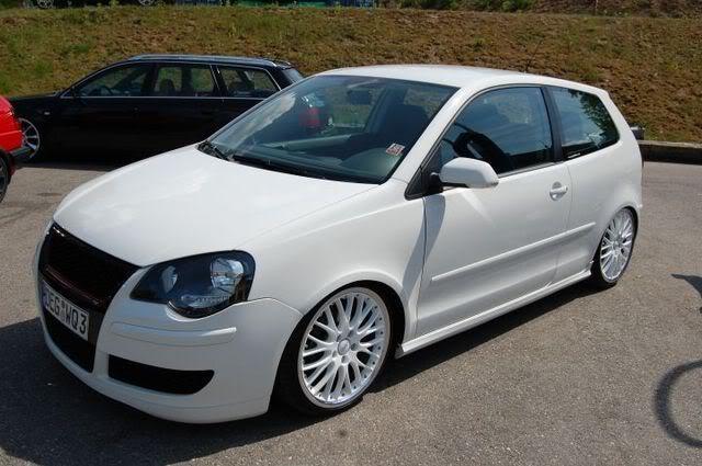

        it doesnt look bad - heres a 18 x 7,5 - and it looks decent
        they will work perfectly with eibachs as long as the drop isnt much more than 40mm - in fact the 30mm eibachs would be perfect - but be very warned - only do this if you always drive on perfect roads
        i had to replace those since i lost three tyres within 6 months - cos that 35 profile really hated hitting potholes - each time it was the sidewall of the tyre that got damaged - so there was no way to repair it - and pirrelli P zero nero tyres are not cheap - so i got rid of th erims and tyres and went to 17" rims with 205/40/17 tyres - and those are holding up much better - also the shocks dont bottom out as much and the ride is generally smoother - so i dont reckon you should go to the 18" rims as a matter of safety and comfort
        but in terms of looks - it can potentially look terrific if you like the oversized wheel look - mine wasnt dropped yet - but remember that the GTI already comes dropped 15mm compared to the other polo's - so with the 30mm springs you will only go down a further 15mm

                    I think a Polo on 18's looks hot.
                    The pics of the Polo here is apparently riding on 18's:

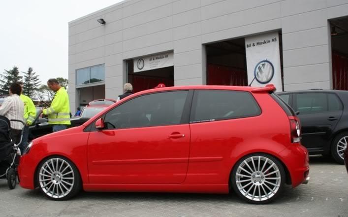

                      Found another picture of a Polo that (looks like) its on 18's.
                        those couple of pictures explain what i meant about wheel gap in my previous post.
                        The red polo looks nice cos there is no wheel gap. When your wheel gap exceeds the tyre height it starts to look a bit naff.
                        Having said that. Not many polos go as low as the red one! most lowered ones ive seen still have a substantial wheel gap
