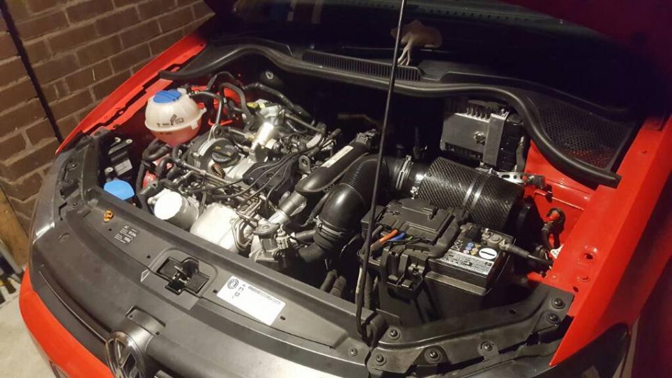

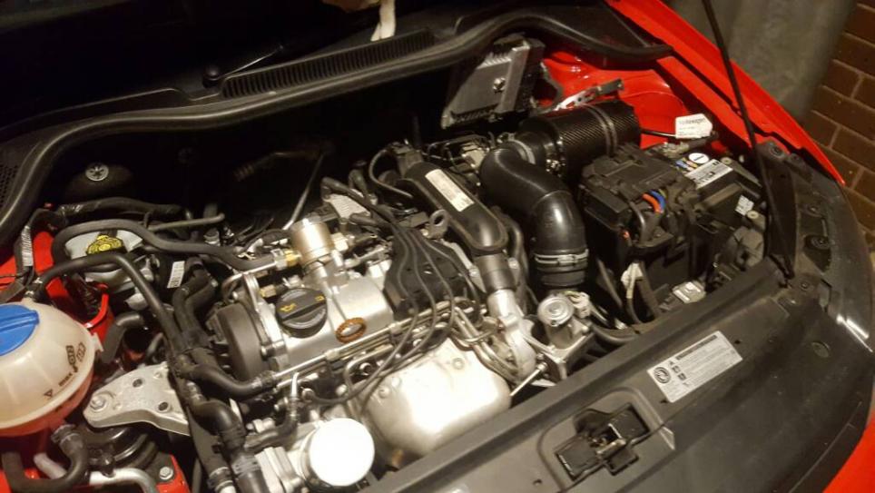

      Hoping my leads will come tomorrow sometime. Been almost a week since I've driven the car. Meanwhile, my ebay intake arrived, so I wasted no time doing a rough install.
      With the stock pipe coming from the cold side of the turbo, it is quite a tight fit, there's on flimsy bracket but I'll do for now.
      Will have installed pics when I get home
