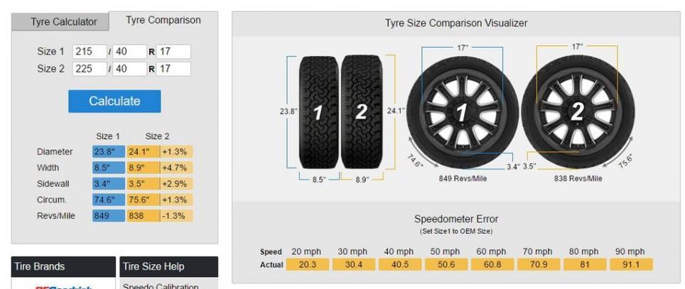

                  I've just ordered a Golf 110TSi Highline for my wife and I noticed that it comes with 225/45/17 tyres on 17 x 7 wheels, but the Polo GTi has 215/40/17 on 17 x 7.5 wheels. One size wider tyres on one size narrower wheels, strange.

                      Personally I'd go for the 225/40/17 it is a more appropriate tyre for a 7.5" wide wheel.

                        Will the 225's fit on the standard Polo GTI rims Gary?
                          They'll fit fine on the upgraded 6C GTI 7.5" wide rims, I probably would go putting them on the older 6R GTI 7" wide rim.
                          Keep in mind that they will knock the speedo out a very small amount, but they should be fine.

                            The actual width of tyres varies between brands (eg; a 225 can be 220 mm wide or 230 mm wide), but in general 215 and 225 are considered the ideal size on 7.5" wheels, with 205 considered the minimum and 235 the maximum.
                            The 225 40 17, depending on the individual tyre, should be around 3% larger in diameter when new which would just about offset the conservative speedo.
