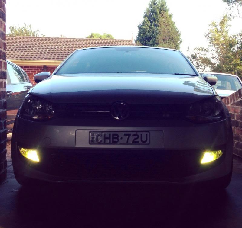

                    Well its all done now, i put in fog lights. Thanks for the help!
