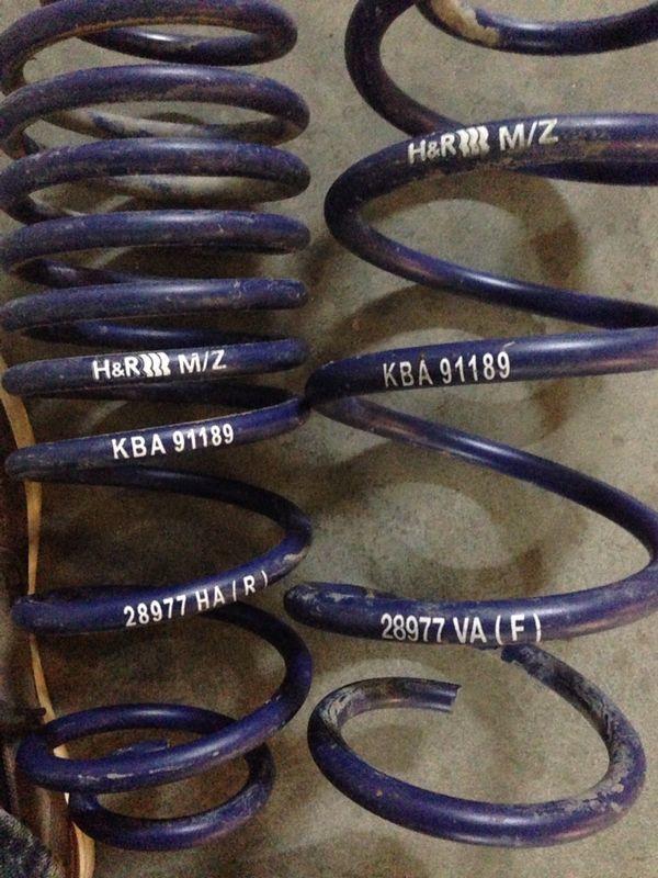

    Hi all,
    I got a H&R spring set from my friend, 25/40.
    But I don't know if it is 28977-1 or 28977-2. My friend doesn't know too.
    Can anybody help me.
    It's how it looks:
    For what it's worth, mine have 91189 on them too. They are the 929kg ones
      I've got a photo on my phone that I'm looking at. Mine are the 28977-2. They have all the same markings as your photo but instead of 'M/Z' at the top mine have 'D/F'.
      So should be the -1's.
        Thanks a lot. Could you upload a photo of yours?
          Hi ukku. Here you go mate.

            Thanks a lot.
            Also there is a white dot near the part number on yours.
