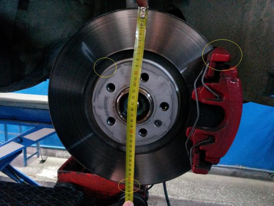

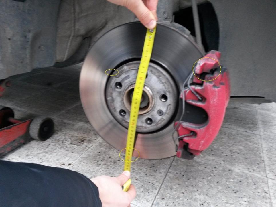

There is a brake upgrade on 2013 Polo GTIs.
2011-2012 models have 288mm front brake disc but 2013s have 312 mm.
You can see 2013s have different caliper carrier and bigger disc.
This one is 2011-2012 Polo GTI:
This one is 2013:
