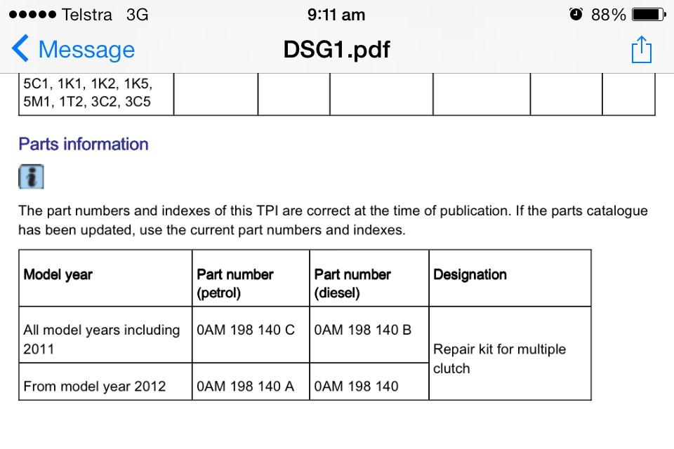

                            And FYI there is a new clutch design starting 2012. This is straight from the TPI on ErWin:
                            Notice the different part numbers between the years.
                            I would like to say though, just becuase there is a different part number doesn't meen the clutch material has been changed which could be what Gavs is talking about
                              Interesting.
                              But my first clutch change was almost exactly a year ago, so presumably I should have had the new design.
                              Didn't last any longer!
