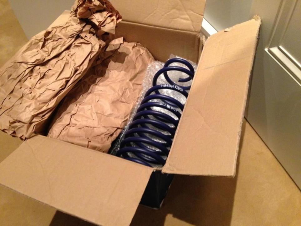

              Thanks for your replies guys.
              I ended going with H&R sports springs 25/40mm. Can't wait to get them on the car
