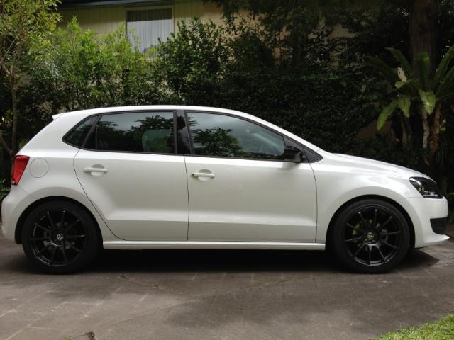

            Car: Polo TSI (Comfort)
            Setup: KW Street Comfort Coilovers
            Wheels: Advan RS 17x8.0 ET37 (Dark Gun Metallic)
            Tyres: Continental Premium Contact 2 215/40R17
            Arch height to ground Front: 624 (+/- 1mm)
            Arch height to ground Rear: 629 (+/- 1mm)
            Thanks to Damien (Gusman) for helping out with my choice of coilovers. Couldn't be happier at the moment. Have rebound damping dialed in at halfway between soft and hard. There is room to go lower but my brief for the Polo is OEM+ setup with practicality. Love this thread as well as it helped me out in deciding my setup. Let's keep it going

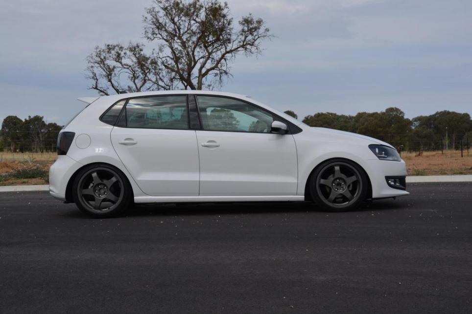

                UPDATE TIME!!!!!
                Gear; KW V1, rear adjusters and rubber perches out, ~10mm thread left at the front (helpers in), arch liners still in (unmodified)
                Wheels;
                Oz Racing Chronos
                Front & Rear; 17x8 et35
                Tyres;
                Nankang 205/40/17
                Arch to ground;
                Front; 575mm
                Rear; 585mm
                @mrdeathlad
                #rollinonskittles
                Shorty exhaust, black tails, Kw V1
                Ronal, Oz, Hoshino Racing

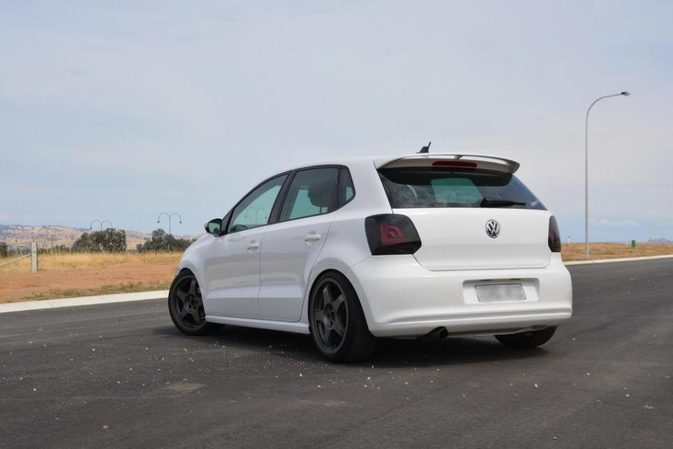

                  check it....
                  Same suspension/tyre set up as above...
                  Wheels:
                  Hoshino Racing Impul RS...
                  17x8 et51 (running 20mm spacer for et31)
                  17x9 et53 (running 15mm spacer for et38 )
                  @mrdeathlad
                  #rollinonskittles
