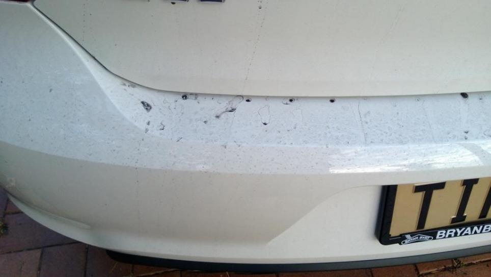

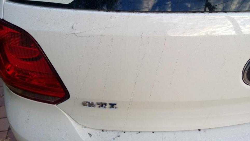

                          I did a clean and after a week it turns to this! around 800kms clocked up so far...
                          you can see where i wiped alot of soot with the finger...
                          I read that for one person it has slowly resolved so thats what im hoping for, not much oil use, still near the top after 1000kms
