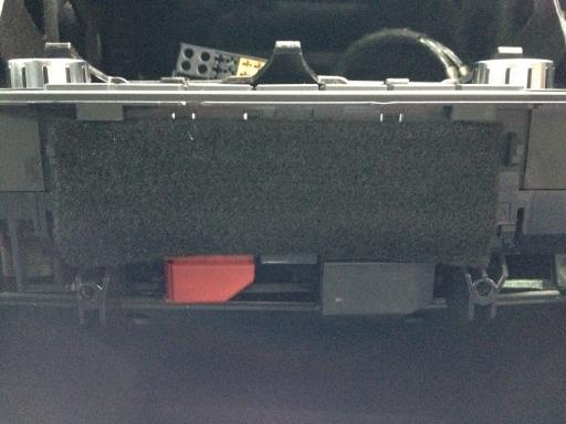

    4. As I said earlier, I asked the dealer to fix these noises and they 'insulated' around the AC unit. Their idea of 'insulating' was sticking some tape in the most useless place. In fact, they've put tape in areas that aren't even in contact with anything else. In the photo above, you can see the small pieces of tape that they put on the AC Unit. They weren't even touching anything!
    Anyway, take the self-adhesive fabric tape and cut a piece about 15cm long and place it on the underside of the AC Unit as illustrated in the picture below:
    This is the most important piece as it actually comes into contact with the underframe of the fascia which, if left uninsulated, could cause squeaks or rattles.
    5. Next, apply two separate pieces of the foam door seal tape and wrap them around the bottom corners of the AC Unit (as pictured below). This area is also important as the corners of the AC Unit also come very close to the underframe of the fascia and a sudden bump in the road can sometimes cause a shock through the dash which will make the two surfaces creak.
    6. Do the same for the top of the AC Unit - Apply two strips of the door seal tape around each corner.
    7. Place a piece of the door seal tape between the fascia underframe and the piece of plastic that's actually part of the dash (above the storage compartment). Sorry, I know that sounds complex and it's hard to describe but this photo may help:
