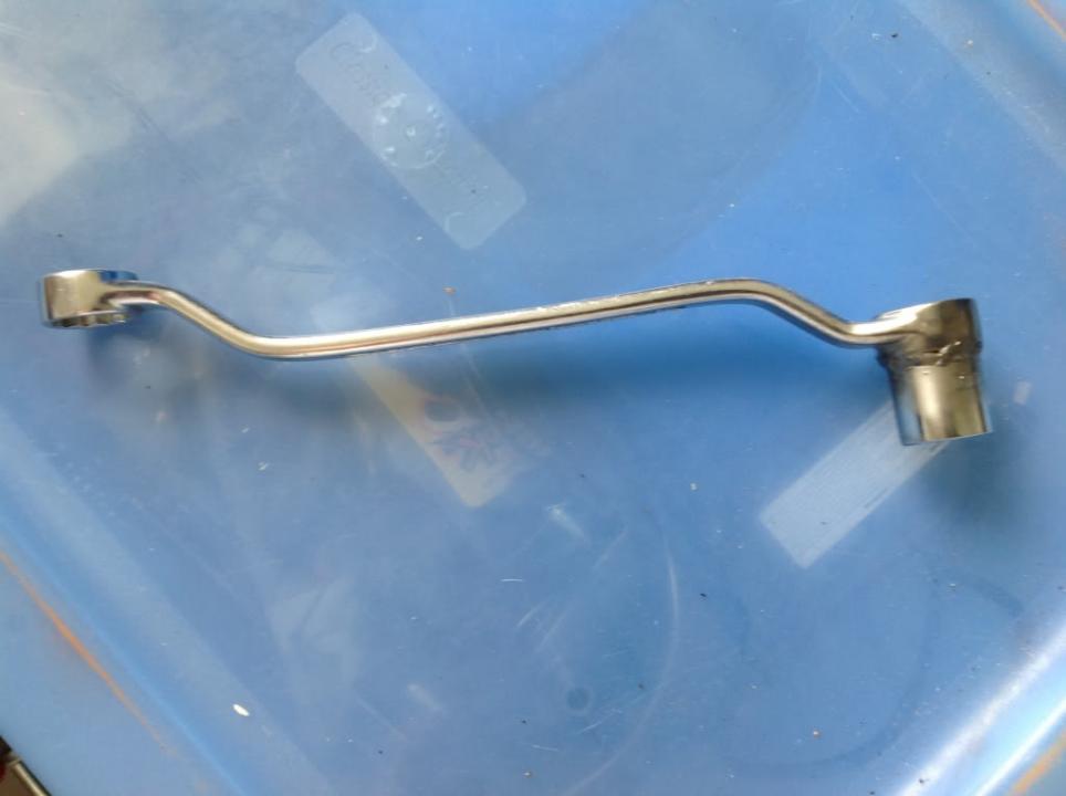

        Wish ebay was around when I brought the "M torx" bits. My set cost me $180 and I've used them maybe twice before got he VW. As for the top strut nut that you need to hold with a Allen key at the same I just mad one myself. I got a old 21mm socket and a offset ring spanner. I ground of a little around the outside of the socket then jamed it up into the ring spanner and welded around the edge and it works a treat.

            Re the strut top tool above, it's amazing what you can do with a $3 ring spanner and some box tube when it's a Sunday and you can't find a deep socket!

              Before bying a "C" socket for the strut top mount, I had purchased a 13/16 inch spark plug socket. (very close to 21mm) This socket has a hexagon end to which a ring spanner can be attached. Being a spark plug socket it has a hole right through, perfect for a 7mm hexagon key to fit in.
              I was almost going to stick with this option however, my mechanic wants to torque all connections and in this case it is physically not possible. Hence $79 for a "C" socket!
