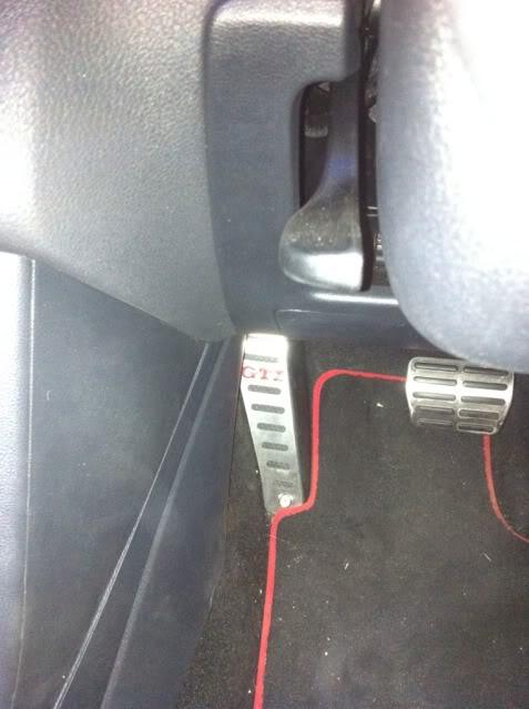

Just did this this arvo so figured i'd do a little DIY guide.
Its a very simple 10minute job and a total cost of $25 delivered.
Tools:
10mm socket
Set of allen keys
Drill
5.5mm drill bit
Wax pencil
Heres what you'll be starting with. Remove the plastic screw from the top of the foot rest.
Mark out where you want the footrest to sit. (I did this before removing the footrest to get the best position)
Drill holes
Attach footrest plate to footrest. The kit should come with allen head bolts, nuts, washers and the bolt seats.
Put footrest back and do up the plastic screw above footrest and enjoy your new look.
