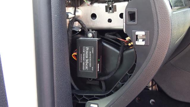

You only need one fuse and some wire and a ciggy lighter socket All up about $15 worth and no cutting into car wiring needed.
Use an acc fuse with power only when ign on
Run the wire up the A pillar and across the front of the roof and you will never see it. See the pics of mine on earlier pages
I have used a power magic but not really necessary.
Pm Me if you want any help.
It also says not to cut the power lead so i havent but dont see why you couldnt.
Mine fits all nicely in the end of the dash.
