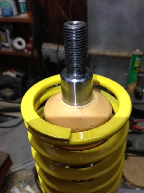

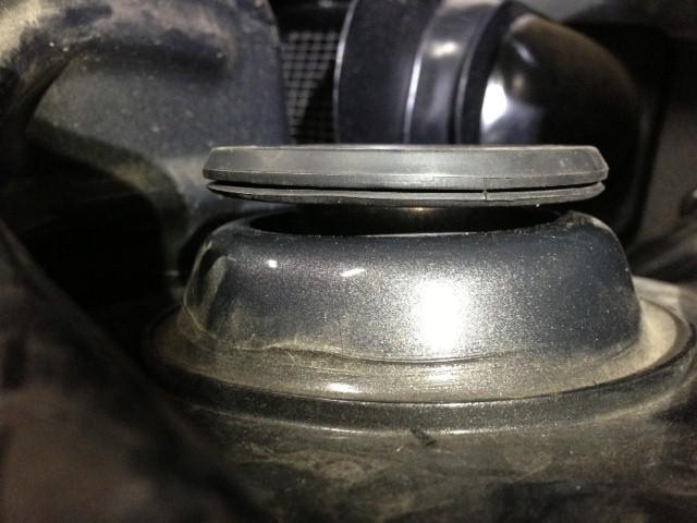

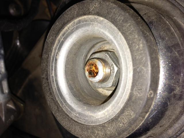

          One thing tho, there is BUGGER ALL thread sticking out the top in the engine bay, the nyloc nut just grabs it fully, bit disconcerting but both sides were the same and there is less thread on the shock than the original ones which is what made me think its normal, I'll post a pic when I get inside

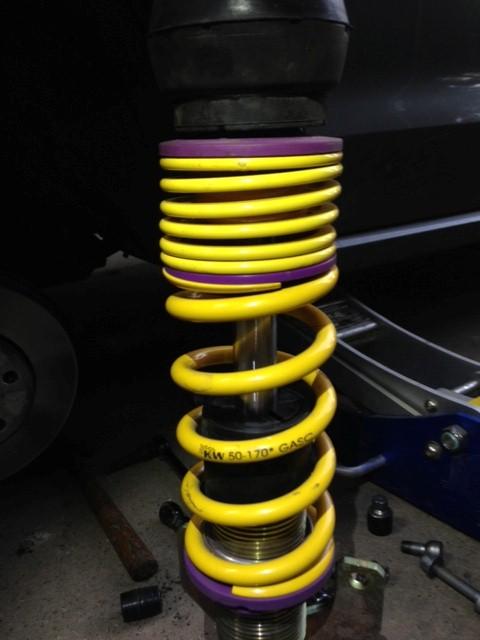

            Standard vs v1. There is no more tighenting to be had, like i say, the actual thread was less on the v1's as compared to the standard ones when compares side by side before even mounting the new mounts and such like.
            I might email Kw and just make sure its okay, as i say, it looked rather worrying. Does anyone else have the same?
            Also.. does anyone know what pitch the nylocs are? i bought some spares' from bunnings (incase i had to remove the top) and they're not the standard M10/1.5 that i think is the 'norm' here?

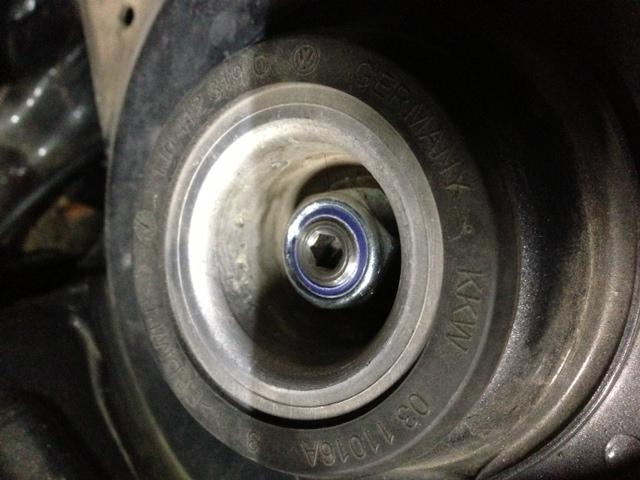

                    If u can really hear it in the cabin it's on the body somewhere isn't it, if you remove the top cap and try it, does it do it then? The top nut is a 22 I believe, I just put locktite on it as I didn't have another one handy given the pitch

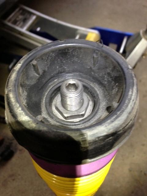

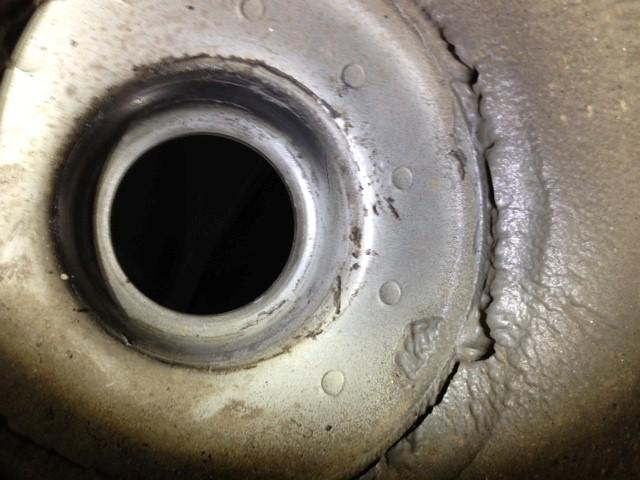

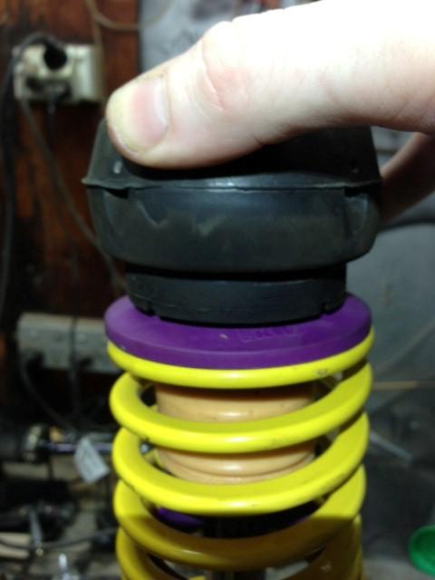

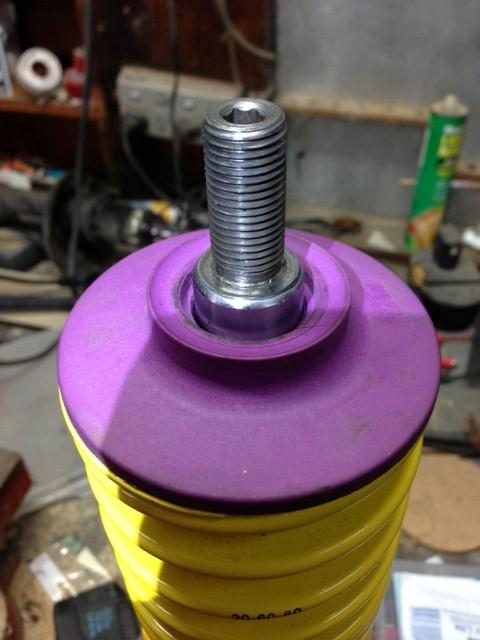

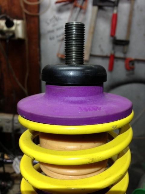

                              I pulled the strut out tonight and gave it the once over, i cannot see anything wrong with it, it looks perfectly normal but i changed out the new febi/bilstein strut mount and put the OEM one back in along with the OEM bearing as opposed to the febi/bilstein one however now it looks like the original strut mount has collapsed?
                              Dont know how this could have happened as when they came out they were both fine, but now its collapesd? well off to VW to get another one tomorrow. I am not going to put in the bilstein one again, not because there is something wrong with it, but im just trying to narrow things down here.
                              Misc pics below... the thread on the KW is indeed 1.5, it looks like the ones that bunnings has are 1.75.
                              so overall... im futher from solving the issue than when I started.
                              One thing that is really bizzare that i cannot figure out why.. the passenger side, you can remove the strut from the housing without removing the lower control arm bolts, once you have the strut seperator in there it just comes out, but on the drivers side, OMFG it was hard to remove, there was so much tension from the sway bar, i had all sorts of trouble getting the link disconnected.. i had both wheels in the air so there was no tension coming from there, i am really perplexed... is that normal?
