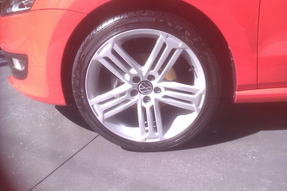

                  These are my 17x7.5 Talladega Reps from the UK.
                  Personally prefer the 17's compared to 18's.
                        Can you let me know the offset of the rim? Does it scrap when car is under heavy load? Also, how does it drive comparing to the stock 17x7? If possible, please provide both positive and negative points. Thanks!
                            45, no scrubbing, I take apex's including the recently removed apex/ripple strip kerbs at the Telstra 500 track with ease/no scrubbing.
                            Cons: the rim is sitting flush with the tyre wall which means I lose the kerb protection that tyres provide (once you touch ever so slightly she will scratch!).
                            So total is 17 x7.5 ET 45
                              Thanks for the info Hail22, is there any noticeable improvement over the 17x7? I remember back them when i had another car and fitted a wider rim, I can feel the breaking is stronger and more stable. Cornering seems to be improved at a good marginal rate too.
                              Is it the same case? Also what size of tyre you are using? is it still 215x40x17?
