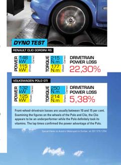

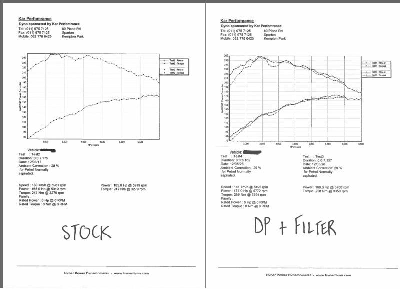

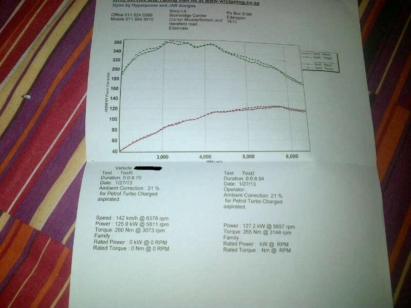

                Hey Gavs, as requested, here are a few graphs and tests in South Africa. Each one taken at a different Dyno
                1) Wheel Power, Stock. At altitude
                2) Topcar Magazine Test. AtSea Level
                This is how they explained that even though the quoted power of the Polo is way down, it managed to out accelerate the Clio
                3) At altitude
                A before and After. Here you will notice minimal gains. If i recall correctly, it was P1 settings. On P2 it was way better.
                4) 2 stock GTi's at a dyno event. Well, the register claims stock.

                    170kw from the Polo is just utter madness! Poor Gearbox

                      170kw is nothing, there are examples pushing up to 190kw. And the gearbox is fine, it's the clutches that are the weak point.
                      The above graphs however are in horsepower. They are stock cars except for one that has a downpipe and Cai fitted.
