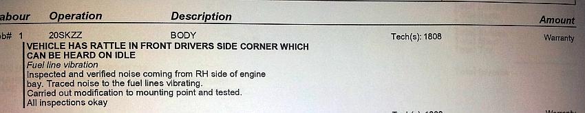

        The wife's 77TSi Fabia Monte had the same problem. Took it in to VW and they fixed it straight away. They said there is a fix for this issue on Polo's and Fabia's so I would ask. Not sure if there was a campaign number for this though. Car has been perfect since. Oh and it was the fuel lines...

          ive got the same thing, asked VW about it and they said it was the fuel lines ratting. the machanic moved it and said that they need to get some part from germany to permanantly fix it. which i though was just stupid. it was fixed for a while but its back now. i dont mind though now that i know its nothing major
