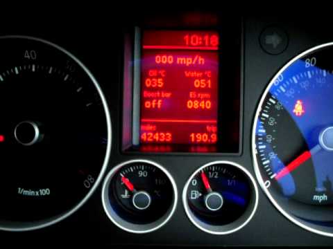

    I was looking a car pc using VCDS permanently Hooke into it and displaying on the rcd 510 in the dash using a video interface. But then I couldn't be bothered hopefully kufatec might develop something like they did for the red highline MFD display with alternate vehicle information...

      That'd be a great idea having it in the MFD display. So Kufatec did something similar? Whats the red highline MFD?

        It's called E-MFA, my friend has it on his MK5 GT Sport. It's pretty nifty.
        I actually think the Kufatec is a rebranded Polar FIS+, who are slowly getting it to work on white dot screens.
        http://www.auto-polar.com/index-showReg-37.htm

          Yep, that's the one.
            very interested in that! is that a matter of "flashing" new software on?

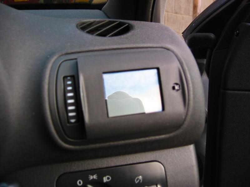

              I haave also been looking for a OBD monitor and where to put it. I came across Liquid Gauge. A friend of mine has it and it is very useful!:
              Contacted them but they will not develop for the Polo
              You can buy the screen without the vent-holder so you can fabricate something by yourself

                  Oh btw the Polar FIS is just been updated to support White Clusters. I've got mine arriving fri/mon.
                    So how does it work? Is it just a plug and play deal?

                      Its basically a unit that plugs into your harness... then you add some coding using VCDS, and bang, you got a whole bunch more info in your MFD.
                        got mine arriving on monday can't wait!
