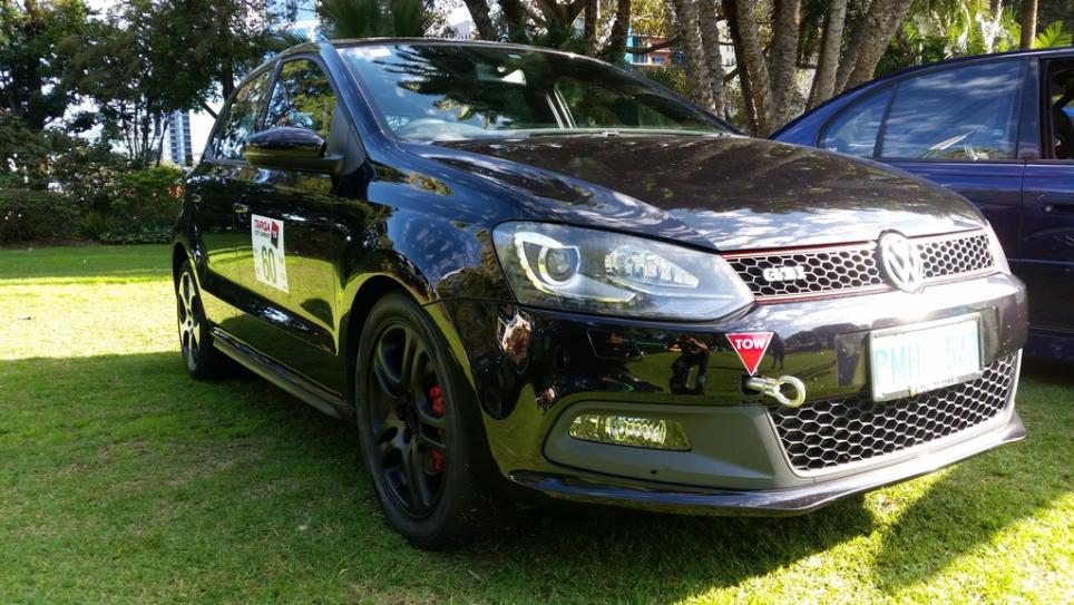

    • Needed some more grip for the Targa West City Sprint so I picked up some WRX (note: NOT Sti) rims and tyres cheap:
      17x7" ET 47
      Tyres: Hankook Z221 Medium semi slicks 225/45R17
      Note: will not fit on the rear without spacers, just rubs on the left arch liner. Also they require the bores reaming out, but that's easy. Will fit spacers before the next run.
