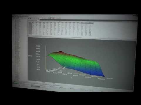

                                This is where APR differs (And Revo & Possible GIAC too) - APR have their own electrical engineering department (numbering in excess of 15 engineers at the moment), these are computer boffins who have the job of breaking down & mapping out the entire ECU's contents, and all the relationships between. Once this is done, they then build tools for the calibrators (a different team of engineers, generally mechanical engineers) to allow them to start manipulating the tables - often spending hundreds of hours on each engines family's calibration.
                                One tool they also build & use in house is ECU explorer, this is an extremely high speed engine data logging tool that needs to be directly wired into the engine CAN harness. VCDS, as great a tool as it is, is simply way to slow (and limited by number of variables) to enable anybody to calibrate & fine tune anything. Part of the reason is VCDS must log via the CAN Controller & access that via the OBD port.
                                Now remember, these are all built in house (here is a small video of it in action)
                                A good example of the extra miles taken to get a product to market - When the Twincharger motor was released (Not available in US), APR flew 3 engineers over for a month to work on this vehicle, and the ECU's. This included a months hire of a dyno.
                                In essence, what this boils down to is the quality of the tune. Look at the power curves, look at the torque curves - that's what is important, how that power is delivered (not discussing the safety side, which is another whole chapter), and support & back up is also a separate issue.
