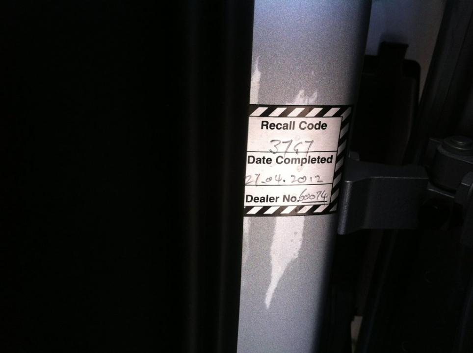

    picked up my polo 3 days ago and iv just noticed a sticker on the drivers side door seal next to the dash that says
    recall code
    37G7
    date completed
    10/07/12
    what does this mean?

    Nothing to worry about, it just means that they have completed the software update on your DSG. Have a look for a thread regarding the update on here, the update has improved life with the DSG especially on hill starts.

        A 37g7 campaign is just a gearbox program campaign. It is done on every Volkswagen model with a DSG gearbox. If you own a 77tsi polo you should also have campaign 24v9 which is for a wastegate spacer to help correct a factory fault.

          Any chance of posting a picture of this? It is just that my Caddy is supposed to have had a software upgrade but I cannot find anything in the paperwork (other than the invoice) to say that it has been done. The invoice also has a statement to the effect that they have done everything they can and that if the condition persists, it must be standard for the vehicle!
            I have this in my new Polo GTI

                  I work at a dealer in Melbourne in the parts Department. As far as I am aware the polo gti might have a 37g7 campaign but that would be about it.
