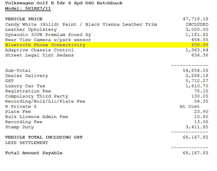

                come to think of it... ill get the purchase receipt for my R (same salesman) and compare the cost of the bluetooth pricing
                  well i looked up the first quote for my R (not the final price i ended up paying) which states the RRP prices for everything. full 9w7 bluetooth set me back $500....
                  from memory thats what my friend paid in her polo
                  the plot thickens....
