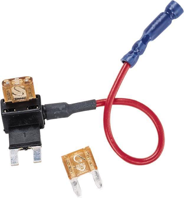

                            im thinking of something like this for the fuse as a perm install but obviously the standard/regular fuse size and not the mini fuse the below image shows
                            thoughts??

                              Yes that would be better but Jaycar sell both standard and mini fuses like that that slot straight in to a POLO as I have used them for my wifes Dashcam Part no SF5120 (mini) You may have trouble fitting that one in with all the fuses close together
                              Wire Tap Mini Blade Fuse 10A - Jaycar Electronics
                              SF5110 (standard) Wire Tap Blade Fuse 10A - Jaycar Electronics
                              and just buy a sz2015 for a line fuse about 750ma. 3AG In-Line Fuse Holder - Jaycar Electronics
