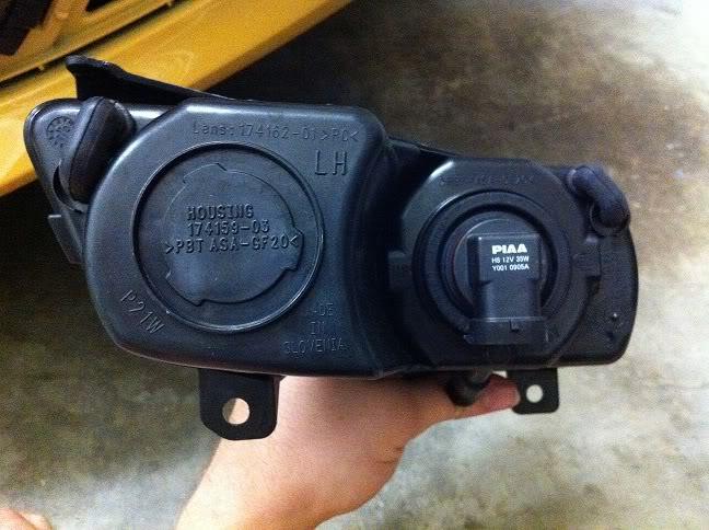

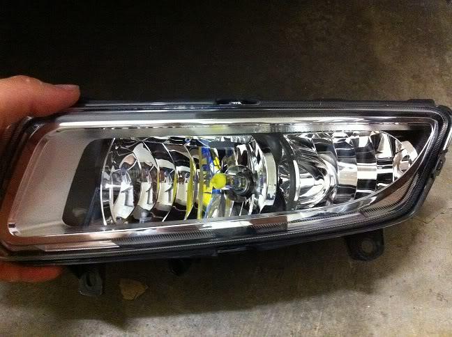

                      Thought i posted up these when i did the bulb swap out on mine, the spot where the cornering lamp would sit is nullified on ours (well i can speak for the 77tsi with sports pack anyway) and instead of using a dedicated lamp for the cornering it uses the fog light provided they are not on already, if the fogs are on they don't act as cornering lamps.

                        I'm sure there would be kits out there to retro fit this feature though if wanted, I just find it odd that they're using the foglight for the static cornering function when it points straight ahead. The reflector for the supplimentary lilght in the foglight housing as well as the xenon light quite clearly point sidways and the light will actually point sideways when they turn on.
