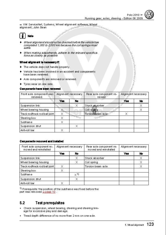

                  Sorry dude, you don't because you physically can't perform any alignment other than toe in / out on the front wheels. This is from the service manuals:
                  Note
                  ♦ Camber correction is necessary only after body repairs. Camber
                  cannot be adjusted. However, it can be mediated by
                  shifting the subframe!
                  ♦ Move subframe only to left or right, but never in or opposite to
                  direction of normal travel!
                  – Remove noise insulation.
                  – Loosen bolts -1- to -4- for securing subframe to body.
                  The camber adjustment range is limited by the tolerances of the
                  holes in the subframe. If the specified value is not reached by
                  shifting the subframe, this and the body must be inspected
                  ⇒ page 1 .
                  – Now camber may be adjusted to specification by moving subframe.
                  – Tighten new bolts for subframe to body to specified torque plus
                  extra turn angle.
                  After shifting the subframe/steering box, clearance between the
                  steering column universal joint and the cutout in the bulkhead
                  must be checked.
                  – Fold floor covering back slightly.
                  There must be a clearance of 5 mm all round between universal
                  joint -1- and cutout in bulkhead -2-.
                  Specified torques
                  Component Specified torque
                  Subframe to body
                  ♦ Use new bolts.
                  70 Nm + 90°
                  5.8 Check rear axle camber
                  Camber cannot be adjusted.
                  If a value lies outside the tolerances, the vehicle's transverse inclination
                  must be checked and, if necessary, compensated for
                  ⇒ page 126 .
                  If the measured values lie outside the permitted tolerances, the
                  axle body must be checked for damage and if necessary renewed.
                  5.9 Check rear axle toe
                  Toe cannot be adjusted

                      In no way am I suggesting gavs information is incorrect, hell its in the manual but Mike...I've been informed by 3 different workshops including Trutrack that I need to get a general wheel alignment after the springs settle for a couple of weeks.
                      FWIW...my car feels damn good with the lighter wheels and h&r springs installed.
                      • Dude, there is no way they can adjust camber or toe on the rear. Its a twist beam rear end (Net build design)
                        The best they can do is manipulate the subframe position (no need unless you get rear ended)
                        The front will only have toe adjustment via the steering rack. And if the tie rods weren't moved when the springs were changed over (they have no reason to be), then toe should be fine also. Get it checked by all means, but dont bend over and accept a charge for a full alignment.
                        • Ok, thyis is a comment for all of the 6R polo owners, if anyone charges you for a wheel alignment, you take a print out of the picture on the last page I posted and ask EXACTLY what have they aligned.
                          This has been brought up amny a time in the Mk4 Golf section of the forum and the basic suspension design on the 6R polo is the same. Many a suspension shop have "aligned" a Mk4 golf but they actually can't, like the manual says (which is the actual VW service manual!) the camber cannot be adjusted, the only thing that can be adjusted is the toe on the front wheels.
                          One suspension place told a Mk4 owner that their car had been in a severe accident because they couldn't do a proper wheel alignment. The owner had owned the car for the life of the vehicle and never pranged it! It's a general school of though amongst these so-called experts that work at these places that this is the normal thing to do........ On a commodore or falcon, yeah. Not on a VW and this is why those of us who have been around on this forum for a while always suggest you go and speak to a proper VW expert, not a generic shop.
