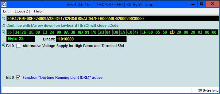

I coded the DRL LED's with VCDS to switch off when the handbrake is up. It only works when the light switch is in the off position. Byte 23, change Bit 4 from 0 to 1.

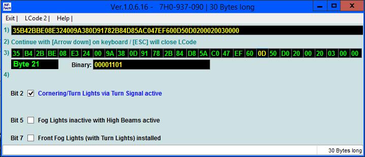

I also coded the static cornering lights to activate when selecting the reverse gear. The light switch must be in the on position with low beam selected. It also only works when the engine is running. Byte 21, change Bit 3 from 0 to 1.
