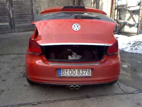

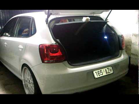

Originally posted by Hail22 View PostWe have the auto opener...but my damn boot wont swing open like those Videos....ugh i saw a Video of a polo TSI (Euro 3 door) but look at the front inlet if you see the video....it has a silver trim...how and where do i get that
You have to unscrew and spin the support 180 degrees so that it will open the boot upon popping.
The polo may not have powerful enough struts to open it however, that is why the mk6 guys overseas have used the skoda struts.
