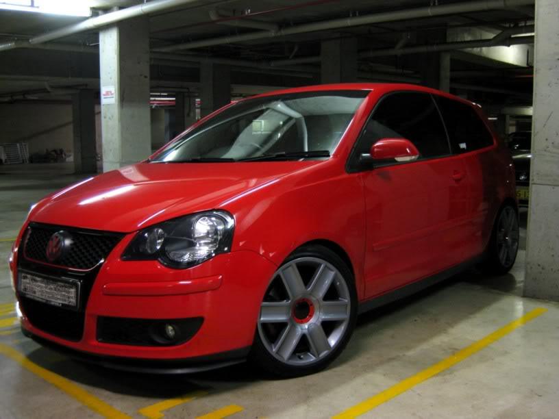

            standard on last polo gti. Only had it come on when new wheels and tyres were fitted, they did not seal them properly.
              So the system was only activated with the new set of wheels? you must be too excited about the car.
              Did you fit your wheels at VW dealer or externally?
                The sensor tripped as I was loosing pressure from 1 tyre. System always worked, but as my tyres were fine never saw the light. Think of it as measuring the tyres rotating. If one tyre goes around 600 times and the other 578, the tyres are not symmetrical. Fitting new wheels is as simple as jacking, remove 5 bolts, pull the old one off, new one on and put bolts back. Audi tt wheels are the way, if your car is the same offset.
                As new Polo is same PCD as the last Polo, Mk4 Golf, early Audi A3, S3 and TT, these are all good options for cheap aftermarket wheels.
                If you have the money, import from Tirerack.com
