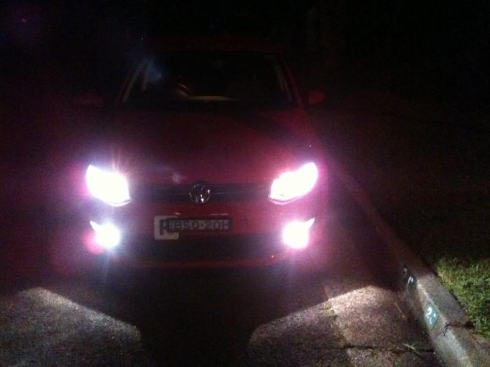

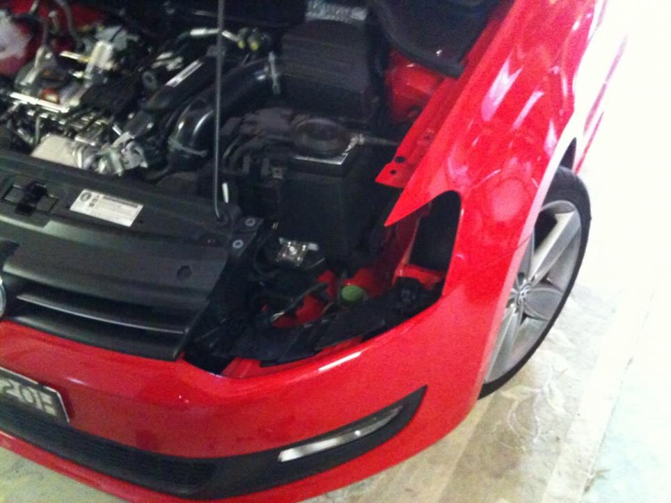

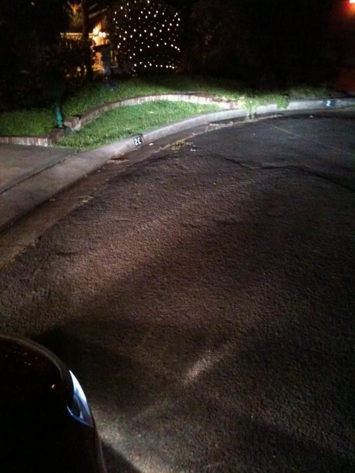

                  heres the photos i promised. and yes, its was a missive job considering it was just changing the light bulbs. had to remove the whole headlight unit, and its stuck in there pretty good.
                  also these are the two bulbs i used;
                  9005 Xenon HID Super White Head Light Bulb High Low Fog - eBay (item 270480799840 end time Dec-30-10 11:05:32 PST)
                  note, these ones have to be mod' to fit the power socket
                  Philips Diamond Vision HID H7 5000K headlight bulbs fog - eBay (item 140473354951 end time Dec-02-10 01:45:04 PST)
