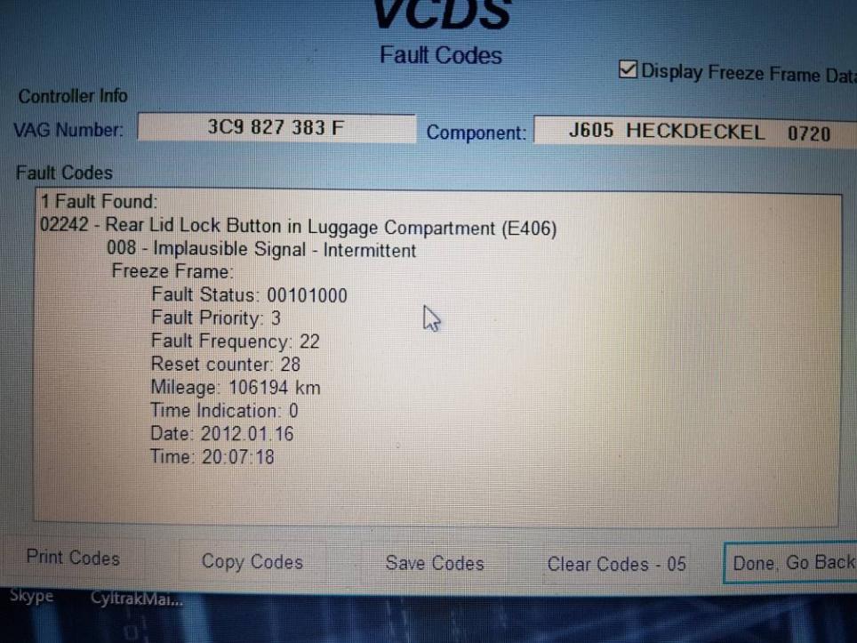

    Hopefully someone can help. Yesterday the powered tailgate on my R36 wagon decided it was no longer going to open fully. Only opens about 1/4 of the way.
    Did a scan this afternoon and got an "implausible signal" error from the rear switch.

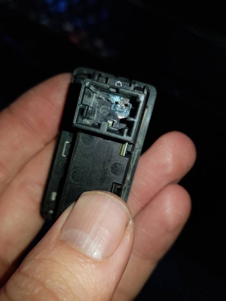

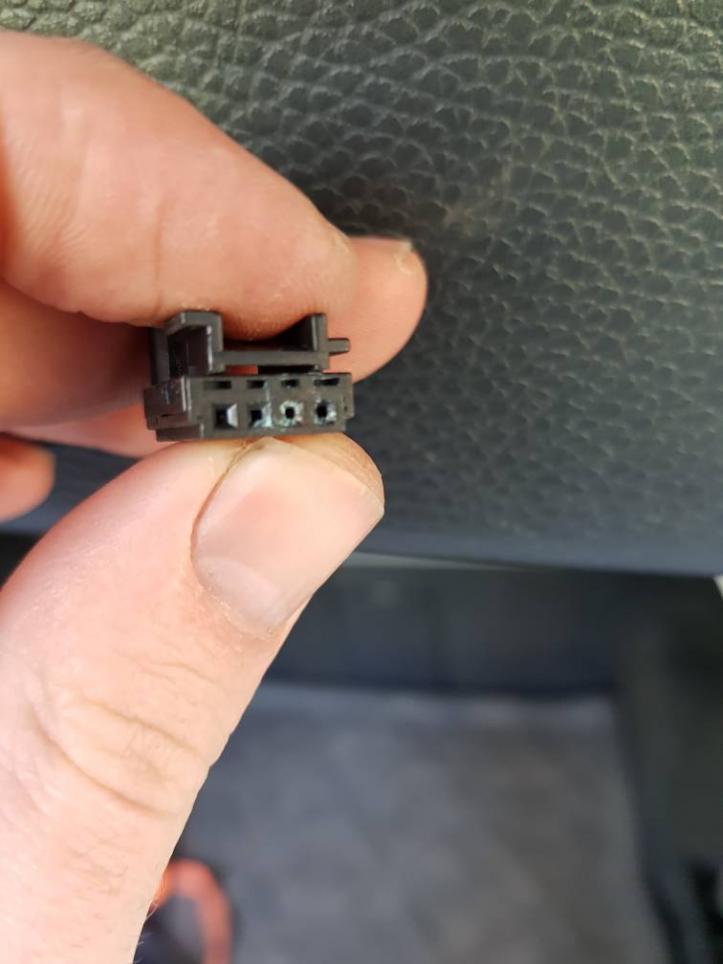

    I took the switch out and it looks like there is some corrosion on the inside of the connector plug and inside the switch.
    I removed the switch, cleared the fault and rescanned. The error is gone now but the door still won't open.
    Any advice? Hopefully I don't have to replace any door motors!?!?
