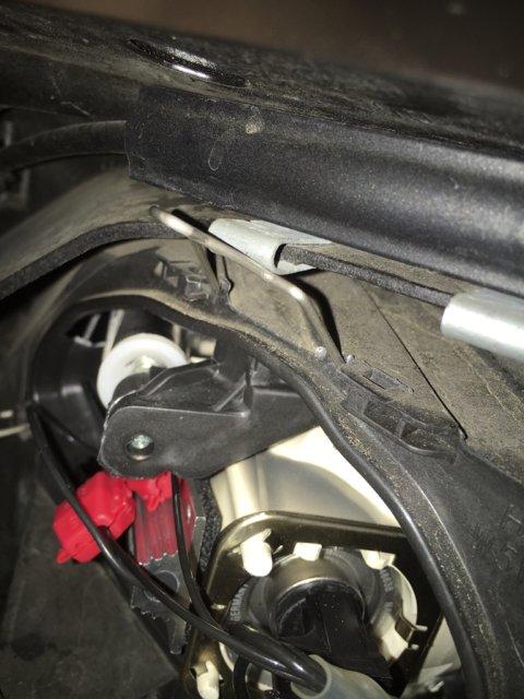

Anyway I haven't had a chance to look around for others however I notice you've used a canbus control unit with the phillips globes, how do you install the control unit?
No probs,Originally posted by cof View PostThanks Heinrich R36, I gave the ones I had another go however one came off and almost fell in to the light bulb cavity...a real pain to get it out and took me ages.
The canbus units are very small and come with 3m double sided foam sticky strips to attatch the unit anywhere.
There is actually enough room to mount them inside the rear of the headlight where the access panel covers.
I will take some pics tomorrow to give you an idea how to fit them neatly.
Here is a pic inside the rear of the headlight housing with the canbus unit connected and stuck to the side.Originally posted by Heinrich R36 View PostNo probs,

Good fit they were.
