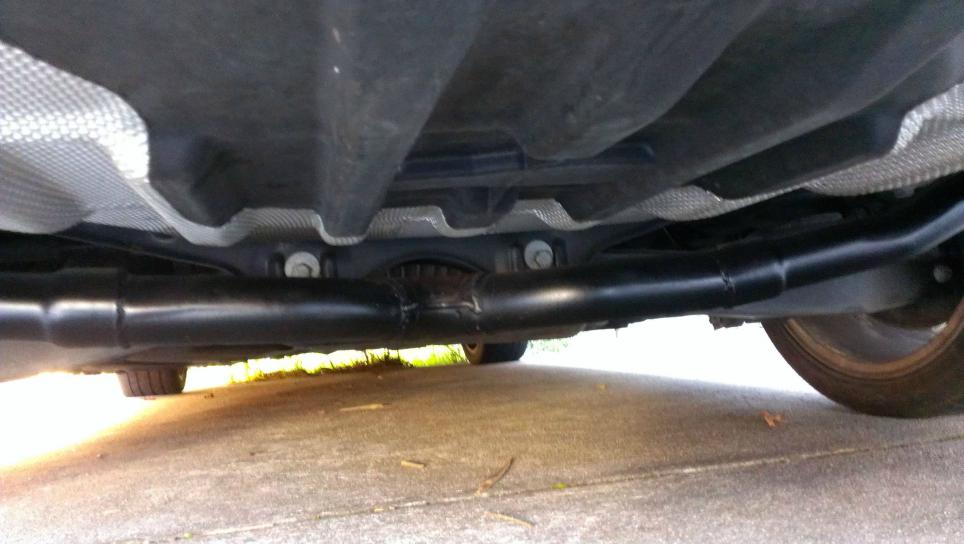

    A review on my recent modification:
    removal of the centre "suitcase" muffler on my 2009 R36
    So, i decided that the sound of my R36 wasn't sufficient to match the performance and really wanted the R32 type of sound. first i went with an EVOMS intake which did make a nice difference but not enough.
    after a bit of searching on the net i couldn't find an affordable exhaust that could be justified for price. i thought the idea of a valved-style exhaust would be perfect (ie valve autoamtically oepns at a certain RPM) and while there was a few german companies that make this exhaust none had a bolt-on for the passat. varex has a VK-05 kit but after contacting them it is apparently discontinued to to unexplained "issues".
    a few had recommended the suitcase delete, and i liked the youtube clips. so i went for it. it cost $100 ($70 labour + $30 for the pipe including the bend) and about 45 mins at the local exhaust shop.

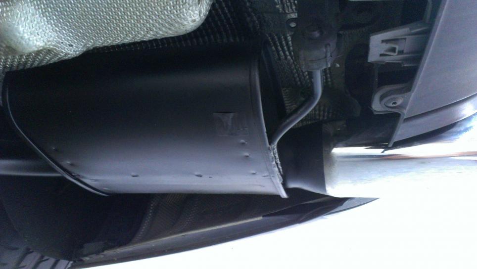

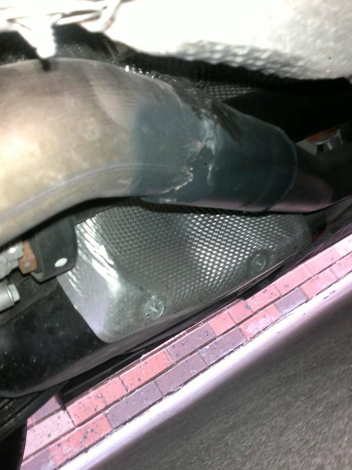

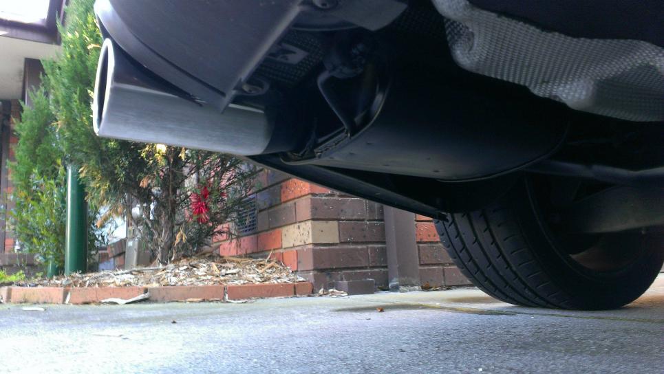

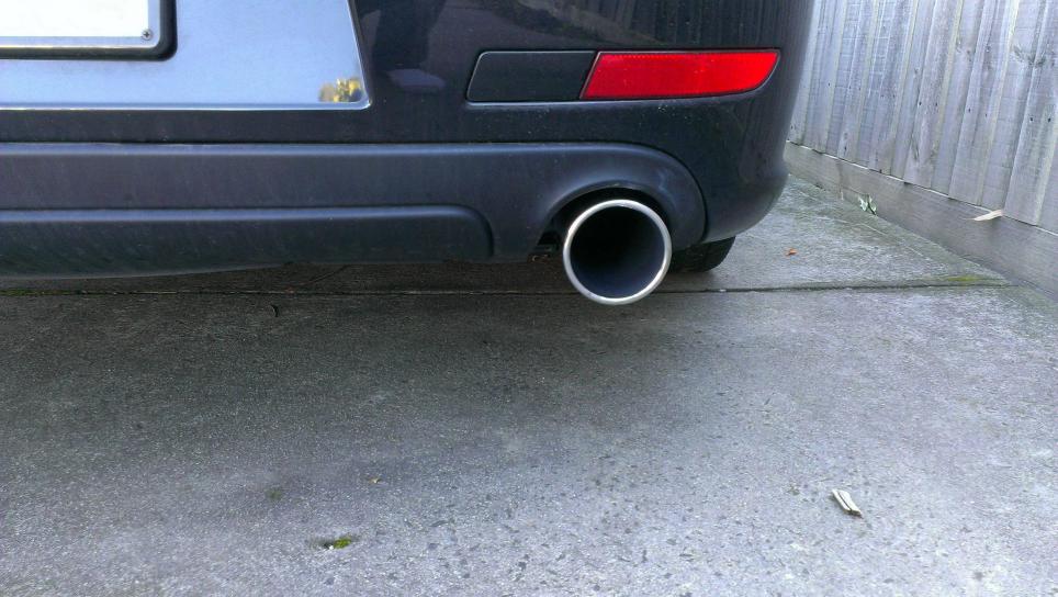

    here is an image of the new setup:

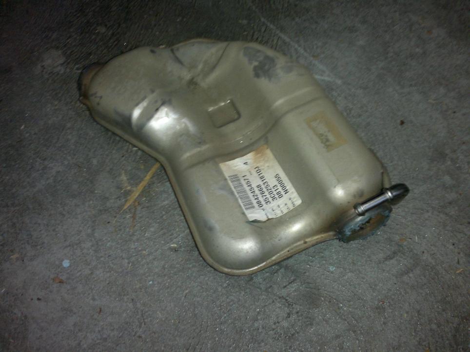

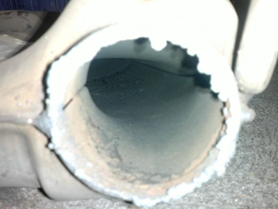

    and the removed muffler:
    its actually an expansion chamber not a typical muffer per se.
    its inside is a large chamber with perforated sides. my shallow understanding is its designed to take out resonating by accelerating exhaust gas into the chamber then slowing it down inside. while its not a direct baffle, its clearly designed to reduce flow compared to a straight pipe.
    the difference?
    performance gain - none. clearly there would be no gain this is a no-brainer but that's not why i did it.
    sound difference? definate change, and i can only assume this is because there is less energy lost as heat/vibration and more kept as sound.
    the sound changes are varied according to RPM:
    at idle it sounds brilliant, has a nice little rumble reminiscent of a previous merc 5L V8 i had.
    at low RPM its sound character is unchagned but its volume is slightly increased.
    at mid-high RPM its sound character is much nicer and also slightly louder than stock.
    can i stress that there is NO drone at any RPM, and at highway speeds it sounds as if it were stock.
    the difference is certainly nowhere near an aftermarket exhaust, but it is much better than stock and it is probably the way the car should have sounded from the factory. if i had to put the volume change on a scale of 0-10, 0 being stock, 6 being loud aftermarket exhaust, and 10 being no muffler... i would probably put it as a 3.
    interestingly when the pipe was first put in, i wasn't entirely happy with the sound (didn't make too much difference) but it seemed to evolve over about a week and after that time settled into its current sound which i am very happy about.
    summary:
    - very worthwile bang-for-buck mod for the difference in sound which has a changed character at idle and mid-high RPM, and a slight increase in volume through all RPMs
    - no drone
    - no power increase
    - overall highly recommended

    Interesting to hear Warren.
    I had the same mod done to my Tiguan and i am also very happy with it.
    Took about a week to settle in (coat itself with exhaust ash) and it sounds a lot more aggressive than the stock system i had (used to be super quiet)
    I have a slight drone around the 3000RPM range but it's hardly ever in that range for more than 1 or 2 seconds.
    Also, the rear muffler weighed about 10kg by itself so there was some "weight reduction" which may give a miniscule performance boost.
    As you said, it's more about sound than performance though with the cat-back section.

        I deleted my centre muffler/resonator in my DS3, and boy it certainly sounds more raw (which is what i wanted). I too wasn't too happy intially, quite metallic and rattling sounds. But after about 2 weeks it sounded GREAT! Also for me it only cost $50 but thats probs because it took only ~25min and also the guy who did it knew I was a uni-student =.=. I love the little bubbly/rumble at idle and the crackle of the exhaust when fuel explodes in the exhuast No droning for me either. I'll take another video of my exhuast in the next week, my first video wasn't very good - too metallic etc. Also as Clay said, I saved some weight too, about 6.5kg for me.
        Also on the DS3 forums, I've seen people get about 1-3 hp from the resonator delete on them and also noticeably improved throttle response. Apparantly that's why you will rarely see DS3's with stock factory setups. Very restrictive exhaust!

          i would argue that 1-3 hp on a dyno is within the normal error margin.
          on a non-turbo car this kind of mod is never goign to add power.
          safe to at least say that its not going to lose power and be happy at that!

                            The result? Well the sound character is very similar to before but the sound is slightly louder at all RPM particularly at idle. Its actually slightly less “boomy” at 2500rpm than with the suitcase, more like stock, and definitely does not drone. Overall very happy with the result and this is really a nice upgrade for the price. And worth it for the nice 4" tips.
                            From what this exhaust guy has been saying about wagon drone it sounds like there has either been exhaust changes at the MY10 upgrade, or the wagon just has a greater propensity to drone for whatever reason (slightly longer exhaust or differences in sound deadening?).
                            Pics:
                            I have another pic of both tips from the rear but have to download it from my phone again.
                            Hope this helps those after an upgrade.
                            I can divulge the name of the exhaust shop if requested.
