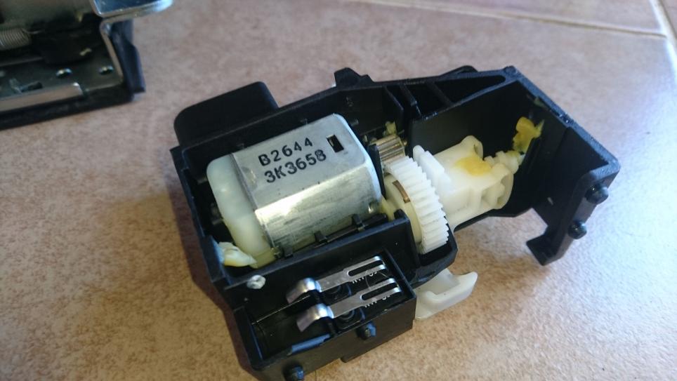

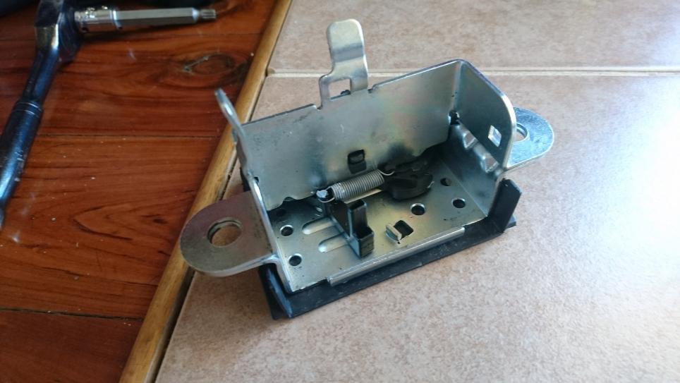

          Hey, Thanks. I ended up buying a used one from a wrecker and it fixed the problem straight away. But you are right. I was curious as to what was in it and pulled it all apart and found 2 switches. 1 was working and the other wasn't clicking properly. Managed to get the one that wasn't clicking properly to work again. Everything else on the latch works as it should though.
          Haha yeah removing the trim seemed a bit scary, felt like i was going to break something. Those metal clips are strong.
          I made a small video and took some photos of what was inside the latch as I couldn't find any photos or videos on the internet. Hopefully helps people out.
          More Photos in an album: VW Tailgate Latch | Flickr
          Hope it may help others in having a go fixing theirs.
