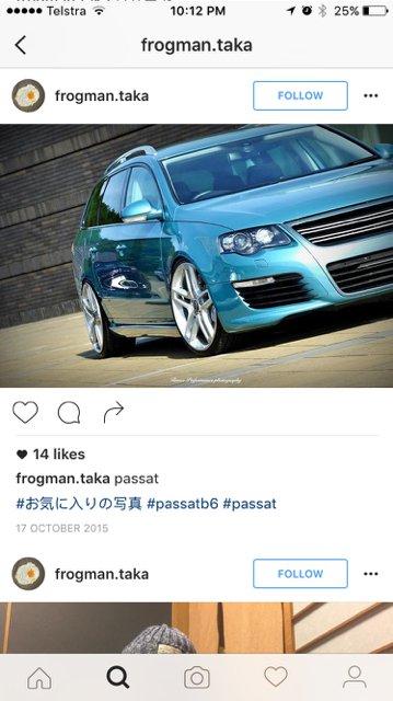

    As far is I can tell, yes. These are G class wheels.
      will need hub rings, different tyres, most likely longer bolts, maybe small spacers pending which wheels exactly
