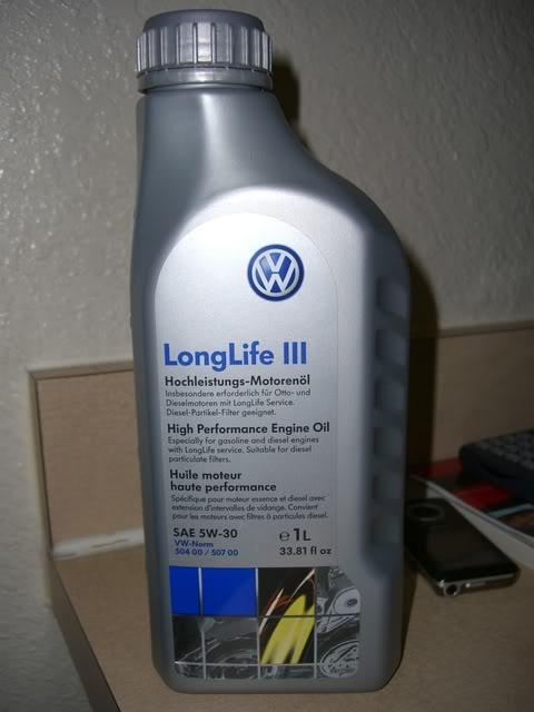

      Yeah the SLX Professional III is what I figured they might be using, I read that and I also have an old 2010 era brochure which has that on it saying it's what they use. However, when I called up and asked, the guy didn't know as they apparently brand it entirely VW now, looks like this:
      Do you know what the difference is between SLX Pro LL3 and the retail Edge is? Both meet same VW specs, but the SLX isn't available to buy anywhere I've seen.

          The oil in the pic is what dealers sell to retail customers from spare parts. The Castrol professional oil is dealer only oil I believe, but the Castrol edge of the same spec would be fine. I have atatched a pic of the oil filter layout showing the drain plug ETC. And yes, a 36 mm socket will make life much easier. Although I have seen filters be replaced using large multi grips!

                              In other news though, as suggested by someone here, it sounds like Castrol Edge SLX Professional LL03 is the dealer oil and isn't available to the public, Longlife 3 is the Volkswagen branded oil that is available to the public and I suspect it is probably just rebranded and way overpriced Edge SLX Pro although nobody seems to know exactly, and Castrol Edge (Also called Edge Titanium) is the off the shelf retail version. There are probably slight variances between the retail and dealer oils as this was the case with the same scenario for BMW (Someone did an oil examination test on the two) but both meet the 504/507 spec and I am comfortable running the retail Edge given the massive price difference and the fact I do changes at 7500km anyway, both are rated for 15,000km.
