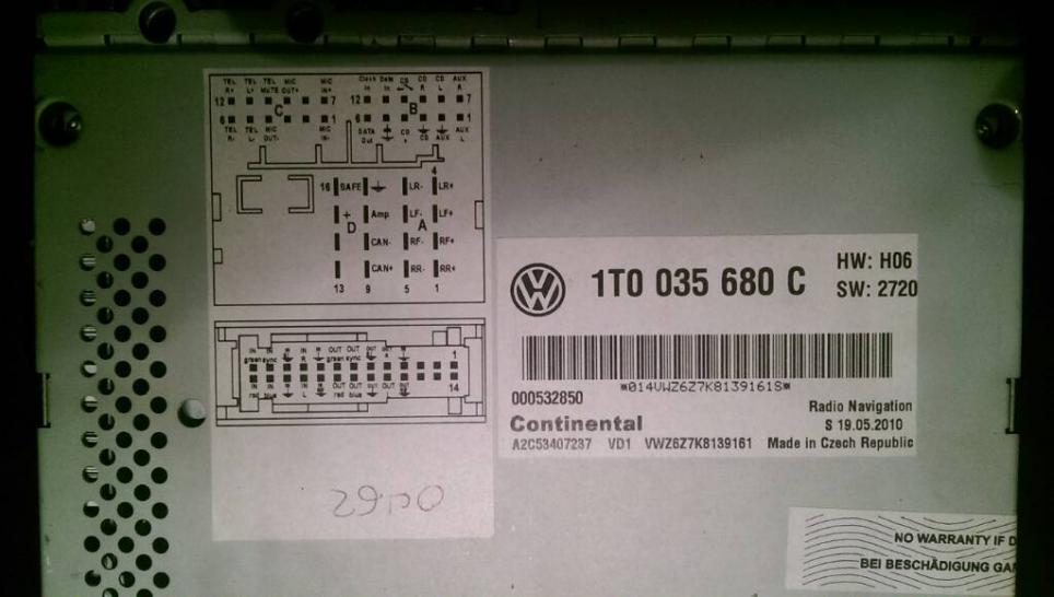

              • #22
                Its pretty straight forward, i wasnt able to get the firmware version off my unit so i ended up pulling the surround off removing the 4 screws that hold it in and reading the model/serial number off the sticker on top of the unit which was real easy.
                R36

                  • #24
                    Ok all done, was basic will give you that I usually snap plastic but all good...
                    So now can you confirm if I need maps disc or should I be ok
                    • #25
                      You can go to 4120 and yes you need a map disc. V7 is about $55 at present
