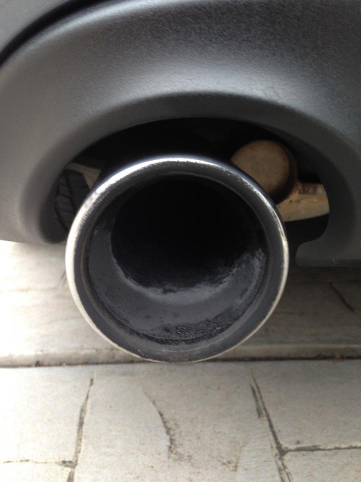

            I had this very task two weekends ago right after I purchased our R36 wagon. The exhaust tips were black around the ends. Although I haven't got them fully shiny around the ends, I used a fine piece of steel wool from under the kitchen sink. It had some soap stuff inbuilt so that provided a bit of lubrication. Make sure you use plenty of water though. I didn't have a heavy compound cut polish to use but I might have a go at fixing the final little bit with some compound when I can find some. I might also have a crack with some machinery as the tried and true method of hand polishing gets a little hard after rubbing for a few minutes! The R36's blow some smoke as they run rich so they don't stay clean for long. I also gave a rub up the inside of the tips too and they come up alright as well. It is a rather stubborn thing to get off believe me. I was at it for a good 20 minutes or so but it is worth it. Give us a look at what they look like now, and then likewise after you shine them up. QBDentFree sounds like he knows what he's talking about so his advice should be noted as well, but everyone's personal experience is valuable on these forums. What does your R look like? Post some pics. They are a great looking machine.

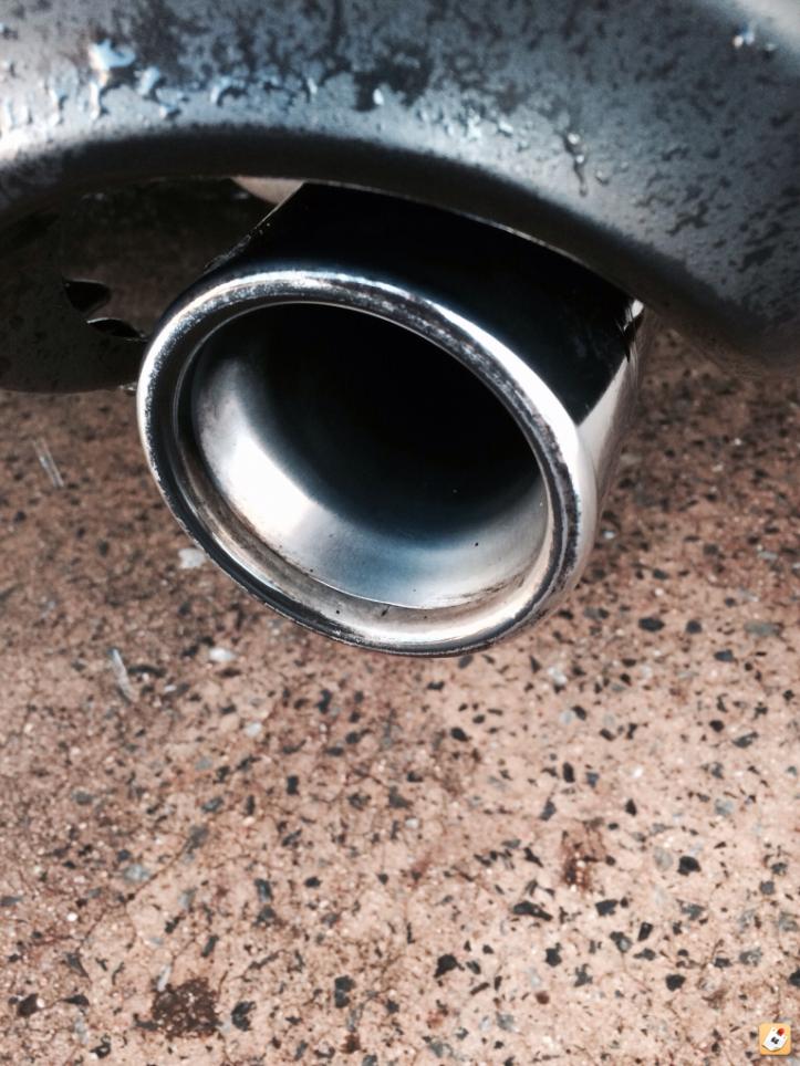

              Some pics.
              The chrome seems to have corroded away. Will try recommendations. Thanks guys.

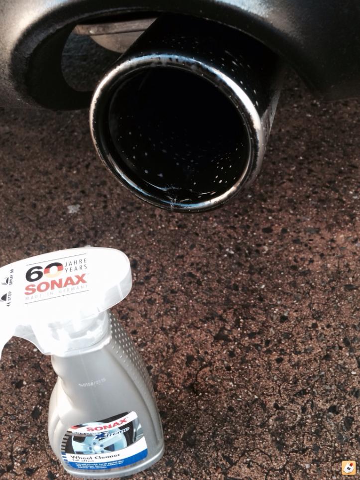

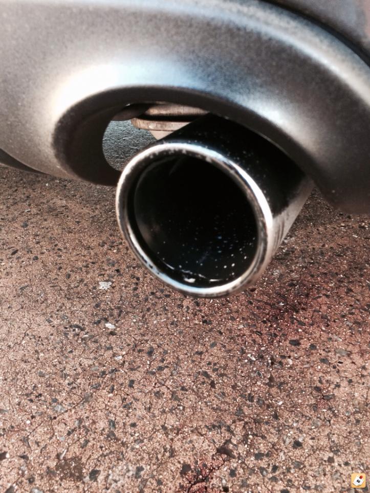

                Grab some wheel cleaner it's only carbon. Make sure u get a wheel cleaner with decon in it which will change color when in contact with carbon. Recommend sonax wheel cleaner or einszett wheel cleaner spray on leave for a few minutes agitate if really bad rinse off and you'll be surprised. Then polish with metal polish and 0000 grade steel wool (extra fine) can also apply a high temp sealant to prevent from happening again. Let us know how u get on

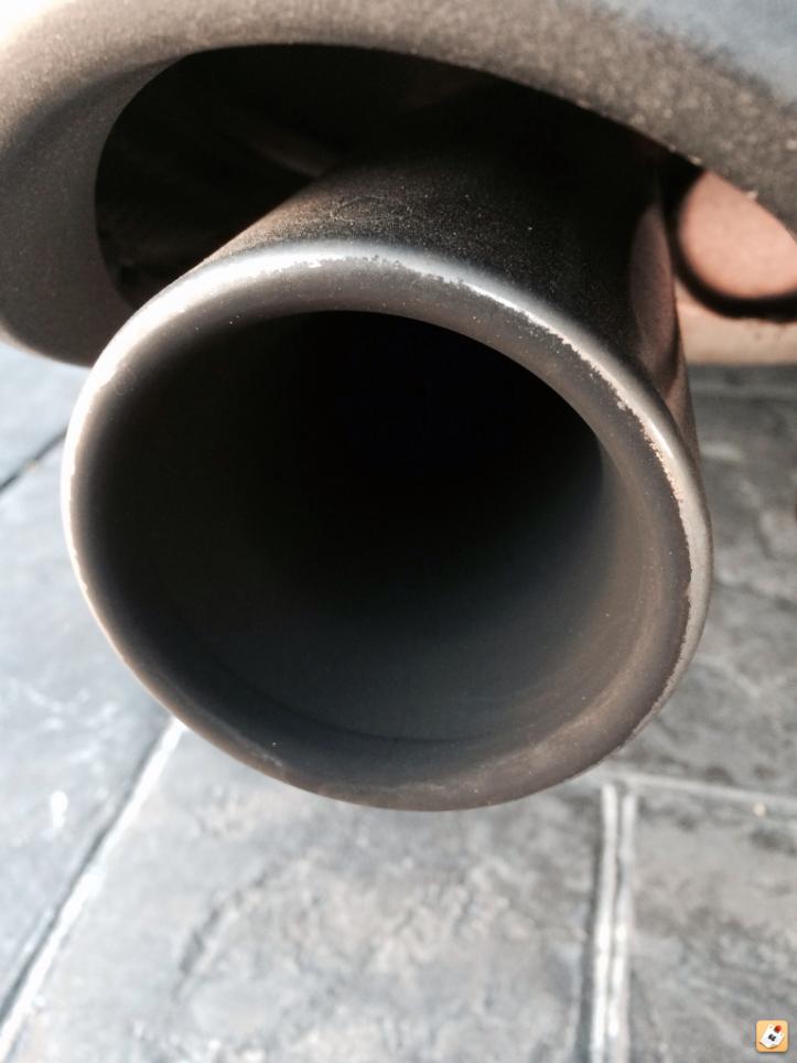

                  Here's some pics with wheel cleaner didn't even have to touch the exhaust. Sprayed on left for a minute or 2 and high pressure rinsed off. No metal polish just a dry microfiber
                  And the finished result
