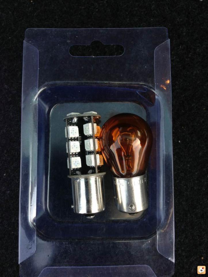

Recently I ordered the rear indicator bulbs from HID's Direct in UK: 581 (PY21W) 27 AMBER SMD LED ERROR FREE INDICATOR BULBS - HIDS DIRECT LTD Store
Again a perfect fit and no canbus error, look great, just a little tricky to replace the nylon bolt that holds the light assembly in place. Don't drop it in the body, it added 15 minutes to my installation time as I had to fish it out..
